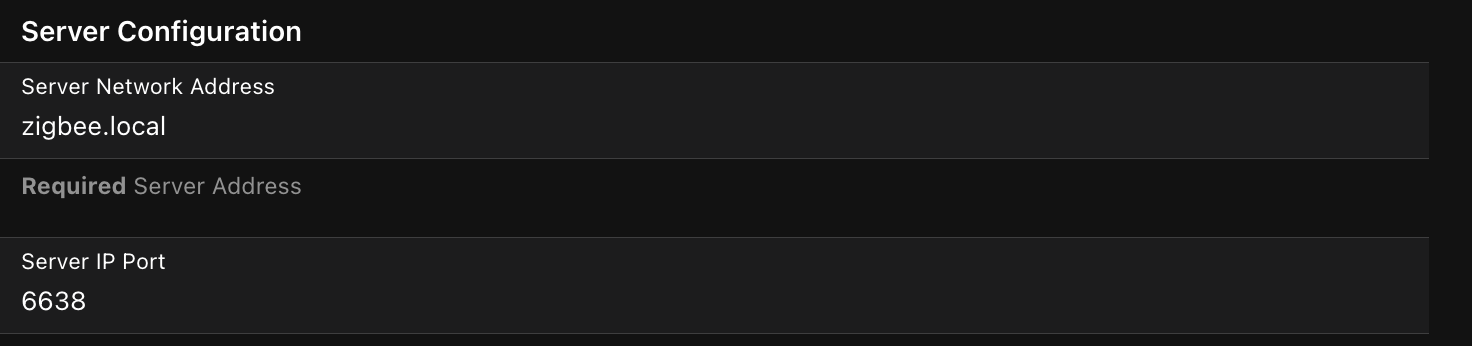

Below are a bunch of screenshots of what I think are all the relevant pages in the SLZB and also the relevant network configuration for the OH thing. It should be easy, but if you have any probs, just shout. This is relatively new functionality in openHAB so it’s always possible there’s bugs when setting it up…
And in the OH configuration -:
Arrived .. plugged in and connected.
I have to say - this was almost too easy, and I’ve paired my first smart plug as a test.
Thank you so much.
