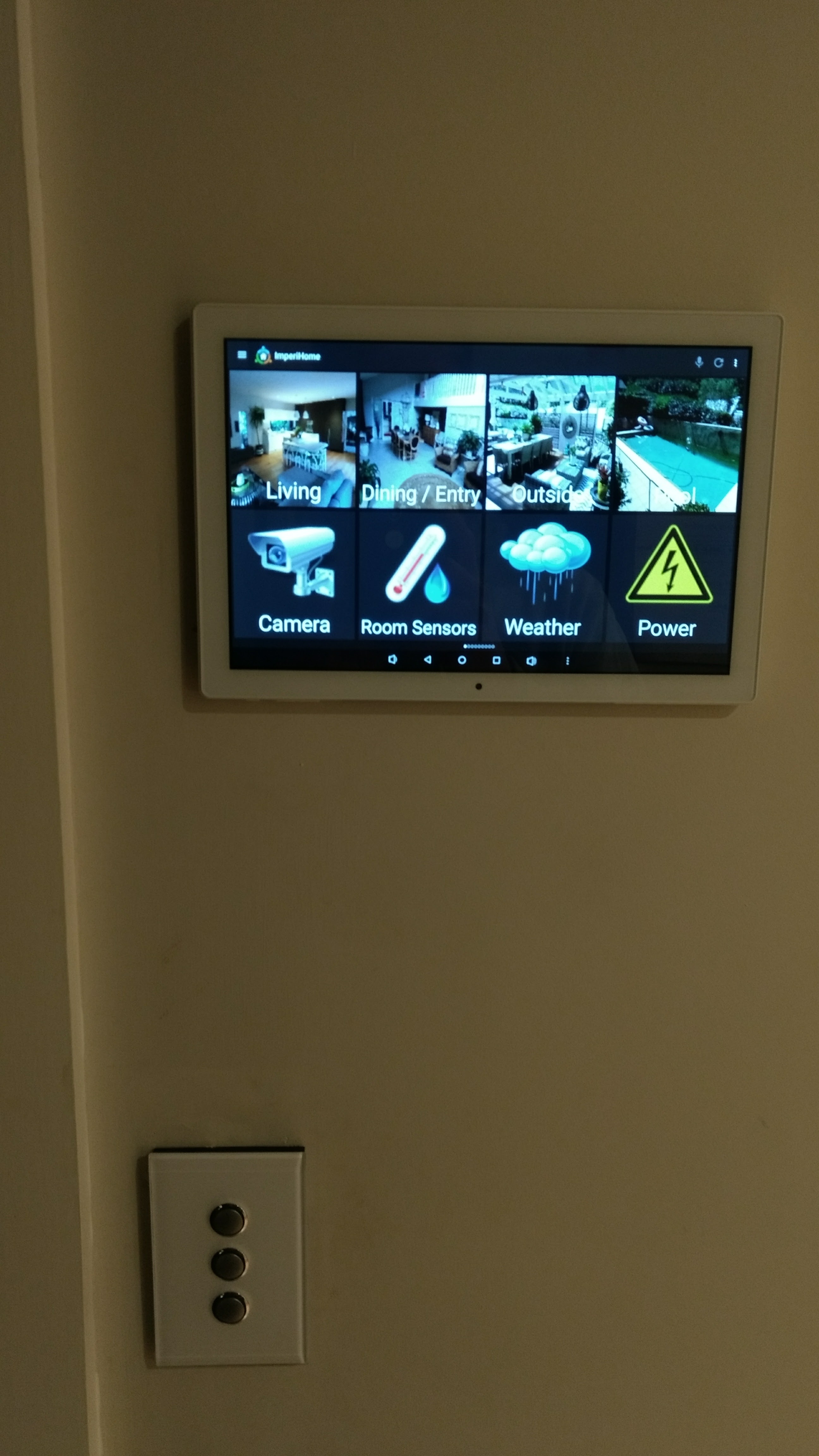

Just thought id share the new tablet ive upgraded to ( running Imperihome of course! )
It’s a 10inch Teclast P10. It was easy to open and because it has a DC jack for charging really easy to solder some wires to so i can power it ( powersupply in roof and cable hidden in the wall )
