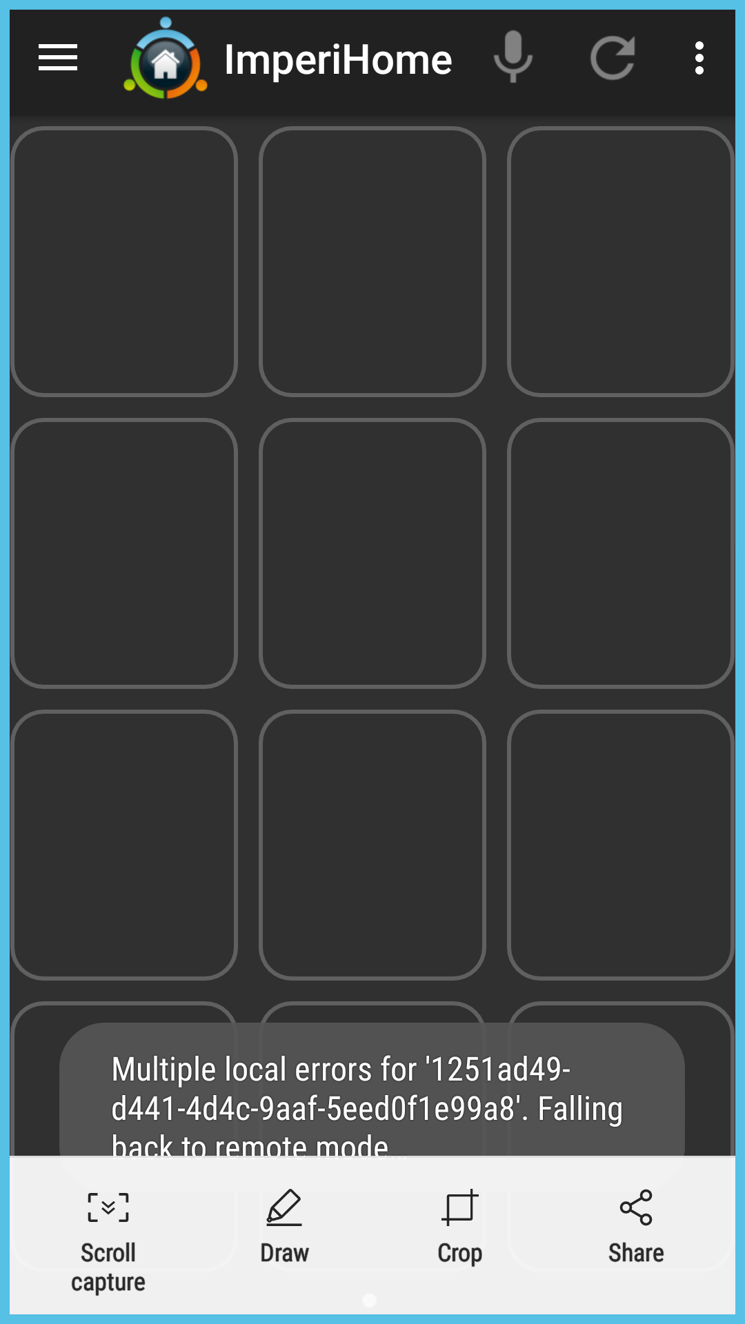

Good Morning and Happy Thanksgiving.Im not sure how to set openhab to debug.
Here are the steps that I did for installing the binding.
  1. Install Imperihome Binding.
  2. I rebooted openhab(just for S**ts and giggles)
  3. I didnt add the imperihome .cfg file since i kept everything default.
  4. I opened the app on my android and clicked add a new system and clicked imperihome
  5. I added the local API which is http://192.168.x.x/8080/imperihome/iss
  6. I didn’t add anything for the external API since I can’t figure out what to insert here. I am using myopenhab.org for remote access at work.
  7. I click next and it says system found and displays a long set of numbers.
  8. Click finish and click the back arrow to go to the main screen and a message comes up that says, see attached photo
    I can’t figure out what is wrong. If you can assist me in how to set the debug log I can send that over.

2017-11-26 13:36:01.659 [ExtensionEvent ] - Extension ‘transformation-xslt’ has been installed.
2017-11-26 13:36:01.664 [ExtensionEvent ] - Extension ‘transformation-exec’ has been installed.
2017-11-26 13:36:01.666 [ExtensionEvent ] - Extension ‘ui-paper’ has been installed.
2017-11-26 13:36:01.668 [ExtensionEvent ] - Extension ‘transformation-scale’ has been installed.
2017-11-26 17:20:47.341 [ExtensionEvent ] - Extension ‘misc-openhabcloud’ has been installed.
2017-11-26 17:41:23.042 [INFO ] [thome.core.internal.I18nProviderImpl] - Locale set to en, Location set to 41.444963200000004,-72.01125979999999
2017-11-26 17:41:23.312 [INFO ] [.dashboard.internal.DashboardService] - Started dashboard at http://192.168.1.2:8080
2017-11-26 17:41:23.318 [INFO ] [.dashboard.internal.DashboardService] - Started dashboard at https://192.168.1.2:8443
2017-11-26 17:41:25.415 [INFO ] [imperihome.internal.ImperiHomeConfig] - Configuration updated
2017-11-26 17:41:25.492 [INFO ] [rihome.internal.ImperiHomeApiServlet] - Started ImperiHome integration service at /imperihome/iss
2017-11-26 17:41:26.190 [ERROR] [io.openhabcloud.internal.CloudClient] - Socket.IO error: not authorized
2017-11-26 17:41:38.701 [INFO ] [basic.internal.servlet.WebAppServlet] - Started Basic UI at /basicui/app
2017-11-26 17:41:38.945 [INFO ] [assic.internal.servlet.WebAppServlet] - Started Classic UI at /classicui/app
2017-11-26 17:41:39.235 [INFO ] [arthome.ui.paper.internal.PaperUIApp] - Started Paper UI at /paperui
2017-11-26 17:41:39.479 [INFO ] [ui.habmin.internal.servlet.HABminApp] - Started HABmin servlet at /habmin
2017-11-26 17:41:39.651 [INFO ] [panel.internal.HABPanelDashboardTile] - Started HABPanel at /habpanel
2017-11-26 18:14:24.324 [WARN ] [eclipse.jetty.servlet.ServletHandler] - /imperihome/iss/rooms
java.lang.NullPointerException
at java.util.HashSet.(HashSet.java:119)[:1.8.0_152]
at org.openhab.io.imperihome.internal.processor.DeviceRegistry.getRooms(DeviceRegistry.java:49)[208:org.openhab.io.imperihome:2.1.0]
at org.openhab.io.imperihome.internal.handler.RoomListHandler.handle(RoomListHandler.java:31)[208:org.openhab.io.imperihome:2.1.0]
at org.openhab.io.imperihome.internal.ImperiHomeApiServlet.service(ImperiHomeApiServlet.java:202)[208:org.openhab.io.imperihome:2.1.0]
at javax.servlet.http.HttpServlet.service(HttpServlet.java:790)[18:javax.servlet-api:3.1.0]
at org.eclipse.jetty.servlet.ServletHolder.handle(ServletHolder.java:812)[81:org.eclipse.jetty.servlet:9.2.19.v20160908]
at org.eclipse.jetty.servlet.ServletHandler.doHandle(ServletHandler.java:587)[81:org.eclipse.jetty.servlet:9.2.19.v20160908]
at org.ops4j.pax.web.service.jetty.internal.HttpServiceServletHandler.doHandle(HttpServiceServletHandler.java:71)[172:org.ops4j.pax.web.pax-web-jetty:4.3.0]
at org.eclipse.jetty.server.handler.ScopedHandler.handle(ScopedHandler.java:143)[80:org.eclipse.jetty.server:9.2.19.v20160908]
at org.eclipse.jetty.security.SecurityHandler.handle(SecurityHandler.java:577)[79:org.eclipse.jetty.security:9.2.19.v20160908]
at org.eclipse.jetty.server.session.SessionHandler.doHandle(SessionHandler.java:223)[80:org.eclipse.jetty.server:9.2.19.v20160908]
at org.eclipse.jetty.server.handler.ContextHandler.doHandle(ContextHandler.java:1127)[80:org.eclipse.jetty.server:9.2.19.v20160908]
at org.ops4j.pax.web.service.jetty.internal.HttpServiceContext.doHandle(HttpServiceContext.java:287)[172:org.ops4j.pax.web.pax-web-jetty:4.3.0]
at org.eclipse.jetty.servlet.ServletHandler.doScope(ServletHandler.java:515)[81:org.eclipse.jetty.servlet:9.2.19.v20160908]
at org.eclipse.jetty.server.session.SessionHandler.doScope(SessionHandler.java:185)[80:org.eclipse.jetty.server:9.2.19.v20160908]
at org.eclipse.jetty.server.handler.ContextHandler.doScope(ContextHandler.java:1061)[80:org.eclipse.jetty.server:9.2.19.v20160908]
at org.eclipse.jetty.server.handler.ScopedHandler.handle(ScopedHandler.java:141)[80:org.eclipse.jetty.server:9.2.19.v20160908]
at org.ops4j.pax.web.service.jetty.internal.JettyServerHandlerCollection.handle(JettyServerHandlerCollection.java:80)[172:org.ops4j.pax.web.pax-web-jetty:4.3.0]
at org.eclipse.jetty.server.handler.HandlerWrapper.handle(HandlerWrapper.java:97)[80:org.eclipse.jetty.server:9.2.19.v20160908]
at org.eclipse.jetty.server.Server.handle(Server.java:499)[80:org.eclipse.jetty.server:9.2.19.v20160908]
at org.eclipse.jetty.server.HttpChannel.handle(HttpChannel.java:311)[80:org.eclipse.jetty.server:9.2.19.v20160908]
at org.eclipse.jetty.server.HttpConnection.onFillable(HttpConnection.java:257)[80:org.eclipse.jetty.server:9.2.19.v20160908]
at org.eclipse.jetty.io.AbstractConnection$2.run(AbstractConnection.java:544)[71:org.eclipse.jetty.io:9.2.19.v20160908]
at org.eclipse.jetty.util.thread.QueuedThreadPool.runJob(QueuedThreadPool.java:635)[83:org.eclipse.jetty.util:9.2.19.v20160908]
at org.eclipse.jetty.util.thread.QueuedThreadPool$3.run(QueuedThreadPool.java:555)[83:org.eclipse.jetty.util:9.2.19.v20160908]
at java.lang.Thread.run(Thread.java:748)[:1.8.0_152]
2017-11-26 18:14:24.405 [WARN ] [eclipse.jetty.servlet.ServletHandler] - /imperihome/iss/rooms
2017-11-26 18:14:24.442 [WARN ] [eclipse.jetty.servlet.ServletHandler] - /imperihome/iss/rooms
Strange, I expected more logging, it shows nothing about parsing your items. There’s an exception in the rooms part which suggests you didn’t specify any rooms at all.
Did you add the required ‘iss’ tags to your items? Can you post the relevant item definitions?

Ok, then let me know if ImperiHome works for you when you have Items with the proper ‘iss’ tags on them.
