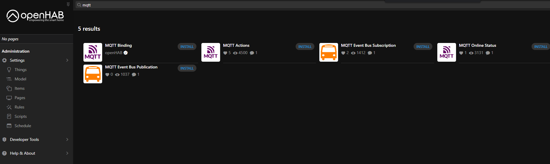

ok, i did the docker approach instead, i was looking for the mqtt homeassistan binding? but where is it?
its not listed there?
It’s part of the MQTT binding. It’s not a separate binding, all three types of MQTT (Generic, Home Assistant, and Homie) are in the same add-on.
indeed, just figured out :slight_smile:

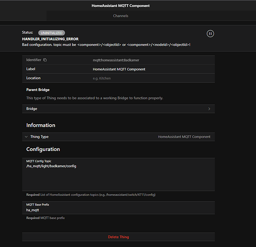

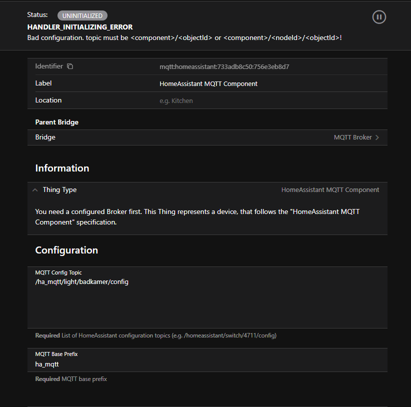

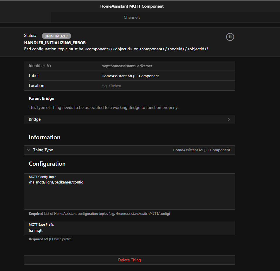

seems the base is configurable after all? i can type it in…
when i save this one, i still get error tough, any idea?

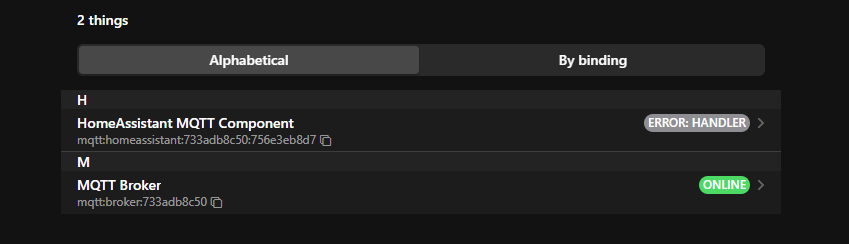

I’m pretty sure you still need to set up the MQTT Broker Thing to start. Then when that’s done you will select that Thing as the “Bridge”.
hmm, ok, added the broker, i see him online, but still:
