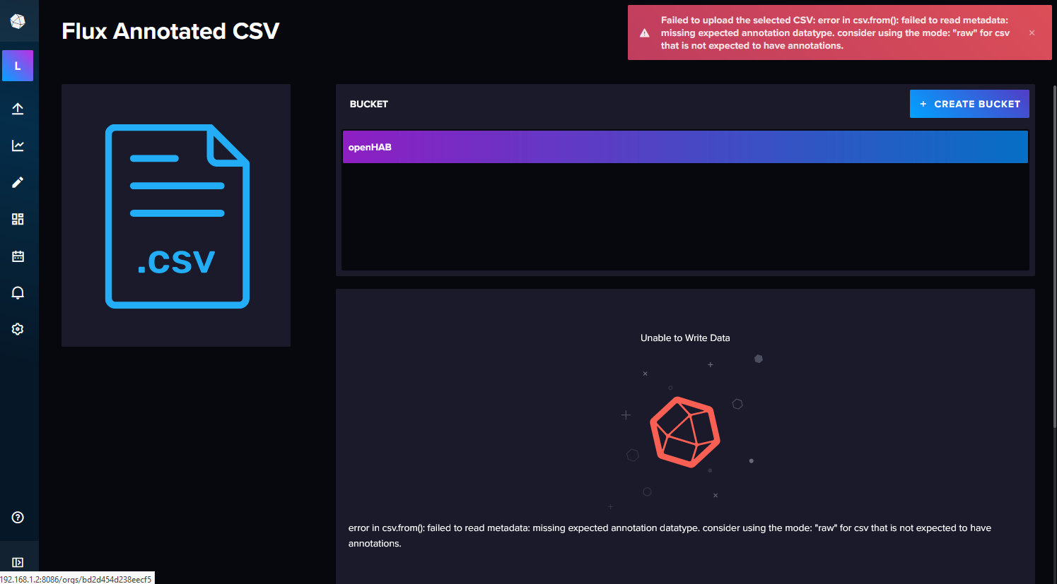

I have managed to create csv files and would like to import the csv files to InfluxDB but when trying to upload a csv file using InfluxDB UI–>Load Data–>Sources–>Flux Annotated CSV I get an error (see the screenshot below):

OK, many thanks. My csv file contains several measurement columns so is this acceptable? Another issue is the order of the columns, can e.g. time be the first column?
Honestly I’m not an influxdb expert, but I’d expect the annotation to take care of that. Otherwise some expert(here or at influxdb) should be able to guide you there.
