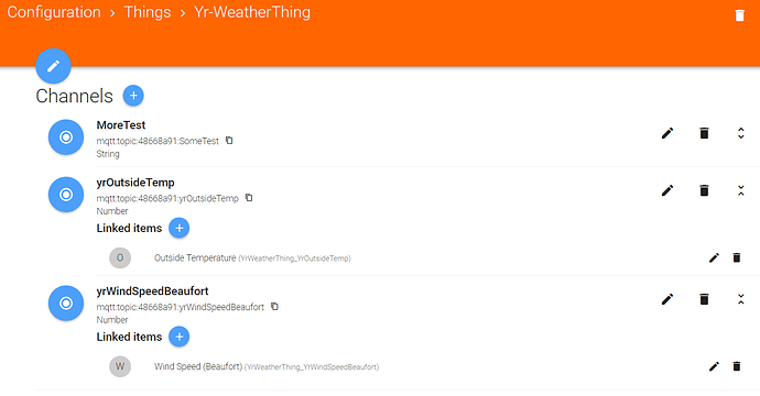

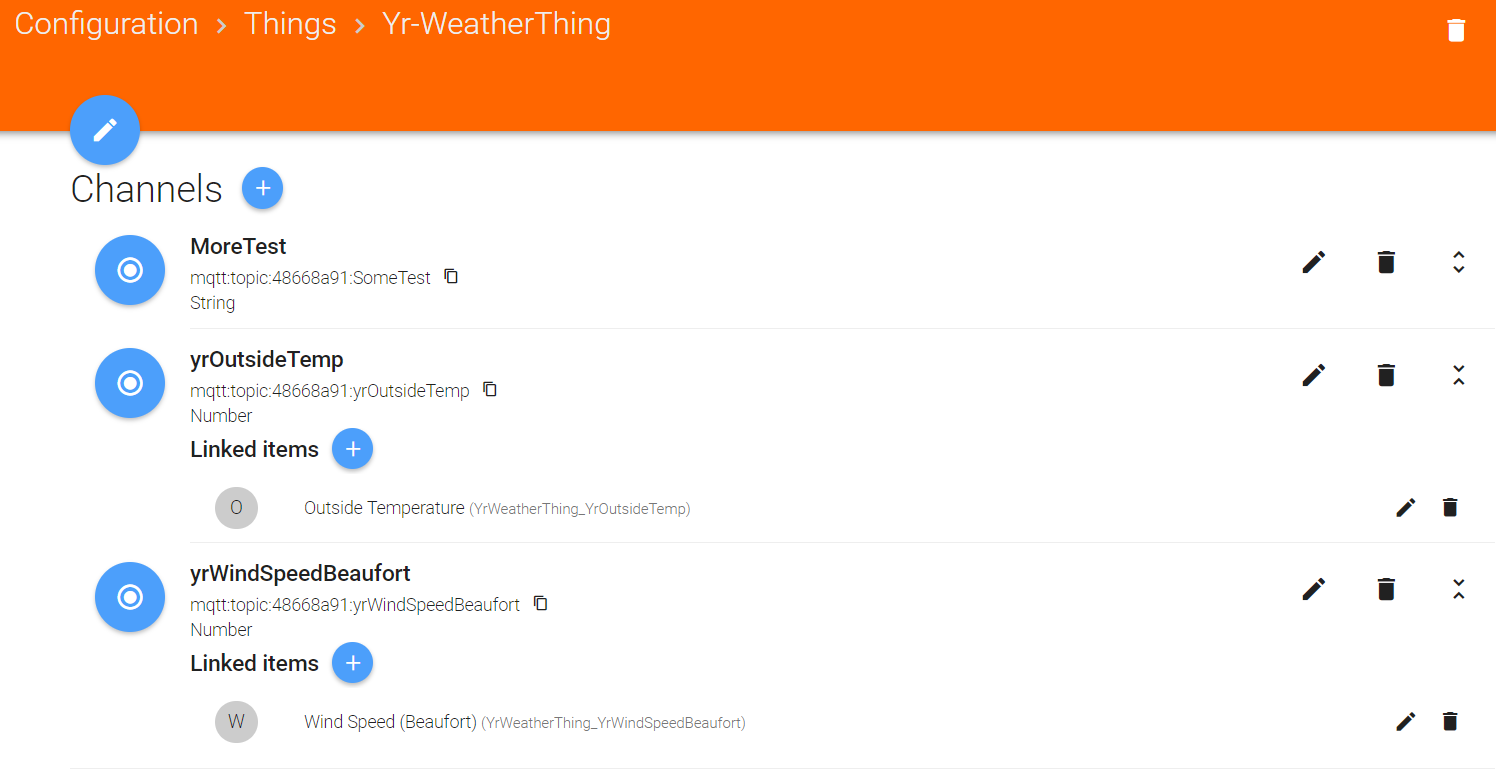

Here is how I have created the MQTT channels and linked them to Items:
Detailed Channel Config:
JSONPath:
JSONPATH:$.weatherdata.product.time[0].location.temperature.@value
Result:

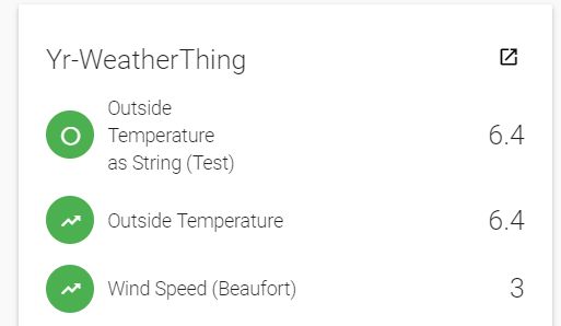

Again, grafana to the rescue to create graphs:
