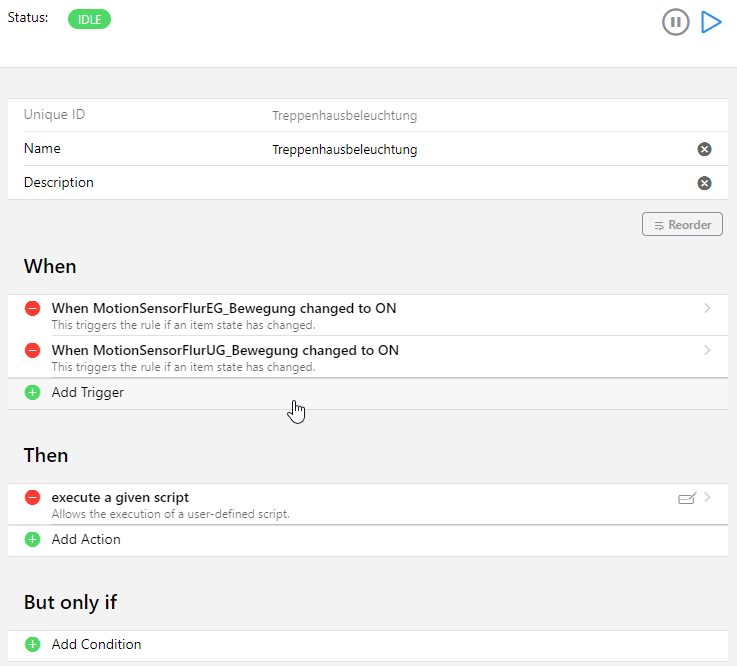

Thats the Rule:
If I only “switch on” with “events.sendCommand(“HMSwitchx4KellerKanal1_State”, “ON”)” it works, but the createTimer throws an error:
2021-01-04 13:39:59.126 [ERROR] [internal.handler.ScriptActionHandler] - Script execution of rule with UID ‘Treppenhausbeleuchtung’ failed: :2:32 Expected an operand but found |
createTimer(now.plusMinute(1), [| events.sendCommand(“HMSwitchx4KellerKanal1_State”, “OFF”)])
^ in at line number 2 at column number 32
