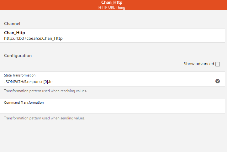

But the problem is when I want to reproduce it under the integrated interface!

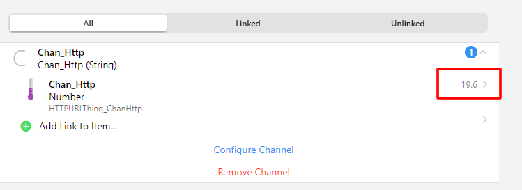

For the thing and the related item I think I understood:
we can see that the linked item indicates the temperature on the channel:

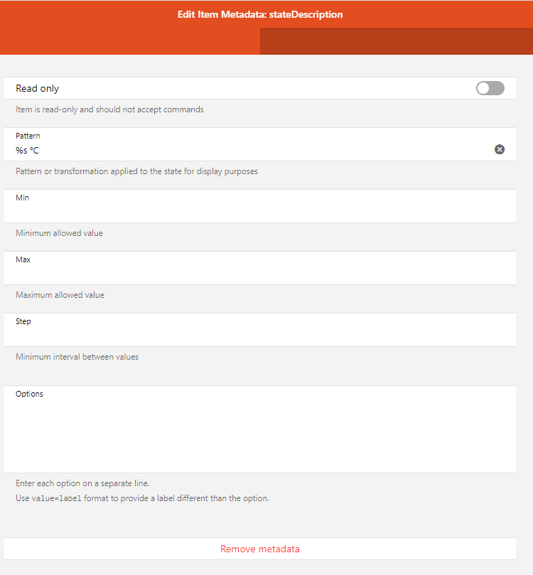

I think the solution is in editing the item and adding Metadata
But where to find the documentation and the syntax?

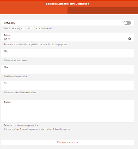

I found the solution after several tries !!!
it was fine in the Metadata options: stateDescription
it was necessary to add% s ° C
j’avais mis [%s °C] mais ca me mettais une erreur
