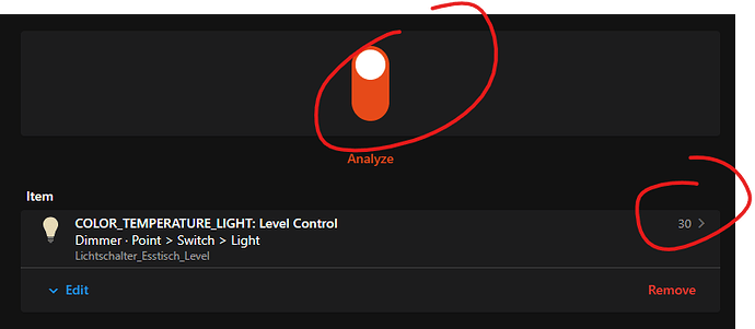

  1. Light off → Alexa “Room xyz to 30%” → Light does not go on
    The 30% are sent correctly to the item…
2024-01-04 21:15:19.409 [INFO ] [openhab.event.ItemCommandEvent      ] - Item 'Lichtschalter_Esstisch_Level' received command 30
2024-01-04 21:15:19.481 [INFO ] [openhab.event.ItemStateChangedEvent ] - Item 'Lichtschalter_Esstisch_Level' changed from 0 to 30
and OH sets the switch to ON…
… but only if I turn the switch above OFF and then ON again, the light goes on, but not to 30% but 100%. :joy:
