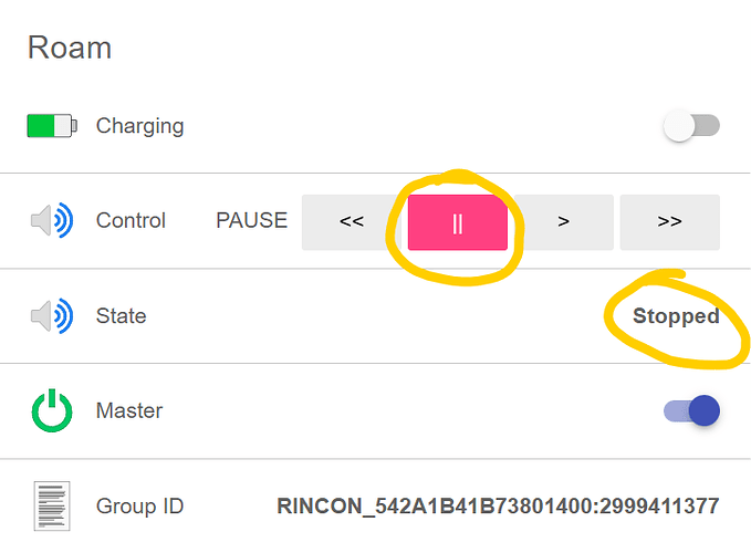

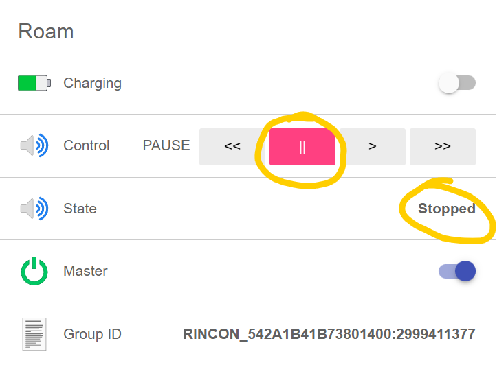

Here are the steps broken down. Once again I’ve made sure to disable all rules for this test:
Note: In the screenshots below, the Sonos app always exhibits the expected behaviour (i.e. it accurately reflects the reality of whether speakers are grouped or playing etc.)
  1. Start playing music in Kitchen [expected behaviour]
  2. Add Conservatory to Kitchen (Kitchen is localcoordinator) [expected behaviour]
  3. Remove Conservatory from Kitchen [expected behaviour]
  4. Add Conservatory to Kitchen again (Kitchen is localcoordinator) [expected behaviour]
  5. Remove Kitchen from Kitchen group
  • Sonos App: Speakers are ungrouped and music plays on Conservatory [expected behaviour]
  • OpenHAB: Both speakers are reported as PAUSE & STOPPED by Control & State channels [unexpected behaviour]
    Exepected behaviour: Conservatory should continue to report a PLAYING state and Group Name should become Conservatory. All Kitchen items are being reported correctly, as is the Conservatory master state, which turns ON.
