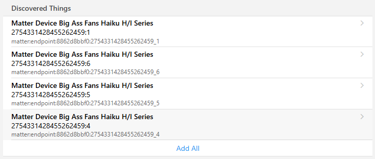

Initial scan results:
2024-11-05 05:46:28.118 [DEBUG] [nternal.client.MatterWebsocketClient] - onWebSocketText {"type":"event","message":{"type":"attributeChanged","data":{"path":{"nodeId":"7886773844386698258","endpointId":4,"clusterId":1026,"attributeId":0,"attributeName":"measuredValue"},"version":1625071445,"value":1958}}}
2024-11-05 05:46:28.120 [DEBUG] [nternal.client.MatterWebsocketClient] - onWebSocketText {"type":"event","message":{"type":"attributeChanged","data":{"path":{"nodeId":"7886773844386698258","endpointId":5,"clusterId":1029,"attributeId":0,"attributeName":"measuredValue"},"version":2754812112,"value":6750}}}
2024-11-05 05:46:28.120 [DEBUG] [nternal.client.MatterWebsocketClient] - attributeChanged message {"path":{"nodeId":"7886773844386698258","endpointId":4,"clusterId":1026,"attributeId":0,"attributeName":"measuredValue"},"version":1625071445,"value":1958}
2024-11-05 05:46:28.121 [DEBUG] [r.internal.handler.ControllerHandler] - No handler found for node 7886773844386698258
2024-11-05 05:46:28.121 [DEBUG] [nternal.client.MatterWebsocketClient] - onWebSocketText {"type":"event","message":{"type":"attributeChanged","data":{"path":{"nodeId":"7886773844386698258","endpointId":6,"clusterId":1030,"attributeId":0,"attributeName":"occupancy"},"version":3194850094,"value":{"occupied":true}}}}
2024-11-05 05:46:28.122 [DEBUG] [nternal.client.MatterWebsocketClient] - attributeChanged message {"path":{"nodeId":"7886773844386698258","endpointId":5,"clusterId":1029,"attributeId":0,"attributeName":"measuredValue"},"version":2754812112,"value":6750}
2024-11-05 05:46:28.122 [DEBUG] [nternal.client.MatterWebsocketClient] - attributeChanged message {"path":{"nodeId":"7886773844386698258","endpointId":6,"clusterId":1030,"attributeId":0,"attributeName":"occupancy"},"version":3194850094,"value":{"occupied":true}}
2024-11-05 05:46:28.122 [DEBUG] [r.internal.handler.ControllerHandler] - No handler found for node 7886773844386698258
2024-11-05 05:46:28.276 [DEBUG] [nternal.client.MatterWebsocketClient] - onWebSocketText {"type":"event","message":{"type":"attributeChanged","data":{"path":{"nodeId":"7886773844386698258","endpointId":1,"clusterId":514,"attributeId":0,"attributeName":"fanMode"},"version":3468296708,"value":0}}}
2024-11-05 05:46:28.277 [DEBUG] [nternal.client.MatterWebsocketClient] - onWebSocketText {"type":"event","message":{"type":"attributeChanged","data":{"path":{"nodeId":"7886773844386698258","endpointId":1,"clusterId":514,"attributeId":2,"attributeName":"percentSetting"},"version":3468296708,"value":0}}}
2024-11-05 05:46:28.277 [DEBUG] [nternal.client.MatterWebsocketClient] - attributeChanged message {"path":{"nodeId":"7886773844386698258","endpointId":1,"clusterId":514,"attributeId":0,"attributeName":"fanMode"},"version":3468296708,"value":0}
2024-11-05 05:46:28.278 [DEBUG] [r.internal.handler.ControllerHandler] - No handler found for node 7886773844386698258
2024-11-05 05:46:28.278 [DEBUG] [nternal.client.MatterWebsocketClient] - attributeChanged message {"path":{"nodeId":"7886773844386698258","endpointId":1,"clusterId":514,"attributeId":2,"attributeName":"percentSetting"},"version":3468296708,"value":0}
2024-11-05 05:46:28.278 [DEBUG] [nternal.client.MatterWebsocketClient] - onWebSocketText {"type":"event","message":{"type":"attributeChanged","data":{"path":{"nodeId":"7886773844386698258","endpointId":1,"clusterId":514,"attributeId":3,"attributeName":"percentCurrent"},"version":3468296708,"value":0}}}
2024-11-05 05:46:28.278 [DEBUG] [nternal.client.MatterWebsocketClient] - onWebSocketText {"type":"event","message":{"type":"attributeChanged","data":{"path":{"nodeId":"7886773844386698258","endpointId":1,"clusterId":514,"attributeId":10,"attributeName":"windSetting"},"version":3468296708,"value":{"sleepWind":false,"naturalWind":false}}}}
2024-11-05 05:46:28.278 [DEBUG] [nternal.client.MatterWebsocketClient] - attributeChanged message {"path":{"nodeId":"7886773844386698258","endpointId":1,"clusterId":514,"attributeId":3,"attributeName":"percentCurrent"},"version":3468296708,"value":0}
2024-11-05 05:46:28.279 [DEBUG] [nternal.client.MatterWebsocketClient] - onWebSocketText {"type":"event","message":{"type":"attributeChanged","data":{"path":{"nodeId":"7886773844386698258","endpointId":1,"clusterId":514,"attributeId":11,"attributeName":"airflowDirection"},"version":3468296708,"value":0}}}
2024-11-05 05:46:28.279 [DEBUG] [r.internal.handler.ControllerHandler] - No handler found for node 7886773844386698258
2024-11-05 05:46:28.279 [DEBUG] [nternal.client.MatterWebsocketClient] - attributeChanged message {"path":{"nodeId":"7886773844386698258","endpointId":1,"clusterId":514,"attributeId":10,"attributeName":"windSetting"},"version":3468296708,"value":{"sleepWind":false,"naturalWind":false}}
2024-11-05 05:46:28.279 [DEBUG] [nternal.client.MatterWebsocketClient] - attributeChanged message {"path":{"nodeId":"7886773844386698258","endpointId":1,"clusterId":514,"attributeId":11,"attributeName":"airflowDirection"},"version":3468296708,"value":0}
2024-11-05 05:46:28.280 [DEBUG] [r.internal.handler.ControllerHandler] - No handler found for node 7886773844386698258
2024-11-05 05:47:23.289 [DEBUG] [nternal.client.MatterWebsocketClient] - sendMessage: {"id":"fa09afc2-3c74-4826-860c-eb805227d90e","namespace":"nodes","function":"pairNode","args":["31108740255"]}
2024-11-05 05:47:23.292 [DEBUG] [ding.matter.internal.util.NodeRunner] - e[0;1;90mMatterController: e[0mCommissioning device with identifier {"shortDiscriminator":12} and 1 scanners and knownAddress "undefined"e[0m
2024-11-05 05:47:23.292 [DEBUG] [ding.matter.internal.util.NodeRunner] - e[0;1;90mControllerDiscovery: e[0mStart Discovering devices using identifier {"shortDiscriminator":12} ...e[0m
2024-11-05 05:47:34.506 [DEBUG] [ding.matter.internal.util.NodeRunner] - e[0;1;90mInteractionClient: e[0mSubscription 927720469 timed out after 66229ms ...e[0m
2024-11-05 05:47:34.507 [DEBUG] [ding.matter.internal.util.NodeRunner] - e[0;1;90mPairedNode: e[0mNode 7886773844386698258: Subscription update not received ...e[0m
2024-11-05 05:47:34.507 [DEBUG] [nternal.client.MatterWebsocketClient] - onWebSocketText {"type":"event","message":{"type":"nodeStateInformation","data":{"nodeId":"7886773844386698258","state":"Reconnecting"}}}
2024-11-05 05:47:34.509 [DEBUG] [nternal.client.MatterWebsocketClient] - nodeStateInformation message {"nodeId":"7886773844386698258","state":"Reconnecting"}
2024-11-05 05:47:34.510 [DEBUG] [r.internal.handler.ControllerHandler] - Node onEvent: node 7886773844386698258 is Reconnecting
2024-11-05 05:47:44.643 [DEBUG] [ding.matter.internal.util.NodeRunner] - e[0;1;90mInteractionMessenger: e[0mRetransmission limit reached, trying to reconnect and resend the message.e[0m
2024-11-05 05:47:44.644 [DEBUG] [ding.matter.internal.util.NodeRunner] - e[0;1;90mMatterController: e[0mRe-Discovering device failed (no address found), remove all sessions for node 7886773844386698258e[0m
2024-11-05 05:47:44.645 [DEBUG] [ding.matter.internal.util.NodeRunner] - e[0;1;90mSecureSession: e[0mEnd CASE session secure/13039e[0m
2024-11-05 05:47:44.645 [DEBUG] [ding.matter.internal.util.NodeRunner] - e[0;1;90mCommission~ontroller: e[0mSession for peer node 7886773844386698258 disconnected ...e[0m
2024-11-05 05:47:44.645 [DEBUG] [ding.matter.internal.util.NodeRunner] - e[0;1;90mPairedNode: e[0mNode 7886773844386698258: Session disconnected, trying to reconnect ...e[0m
2024-11-05 05:47:44.650 [DEBUG] [ding.matter.internal.util.NodeRunner] - e[0;1;90mPairedNode: e[0mNode 7886773844386698258: Error resubscribing to all attributes and events. Try to reconnect ... e[31mNo operational address found for node 7886773844386698258
2024-11-05 05:47:51.809 [DEBUG] [ding.matter.internal.util.NodeRunner] - e[0;1;90mCaseClient: e[0mCase client: Paired successfully with udp://fe80::8e4b:14ff:fe54:cd90%eno1:5540 and parameters e[34midleIntervalMs: e[2;39m500 e[0;34mactiveIntervalMs: e[2;39m300 e[0;34mactiveThresholdMs: e[2;39m4000 e[0;34mdataModelRevision: e[2;39m17 e[0;34minteractionModelRevision: e[2;39m11 e[0;34mspecificationVersion: e[2;39m0 e[0;34mmaxPathsPerInvoke: e[2;39m1e[0m
2024-11-05 05:47:51.810 [DEBUG] [ding.matter.internal.util.NodeRunner] - e[0;1;90mInsecureSession: e[0mEnd insecure session insecure/2070157823708401546e[0m
2024-11-05 05:47:51.949 [DEBUG] [ding.matter.internal.util.NodeRunner] - e[0;1;90mInteractionClient: e[0mSubscription successfully initialized with ID 664765033 and maxInterval 60s.e[0m
2024-11-05 05:47:51.992 [DEBUG] [nternal.client.MatterWebsocketClient] - onWebSocketText {"type":"event","message":{"type":"nodeStateInformation","data":{"nodeId":"7886773844386698258","state":"Connected"}}}
2024-11-05 05:47:51.993 [DEBUG] [nternal.client.MatterWebsocketClient] - nodeStateInformation message {"nodeId":"7886773844386698258","state":"Connected"}
2024-11-05 05:47:51.993 [DEBUG] [r.internal.handler.ControllerHandler] - Node onEvent: node 7886773844386698258 is Connected
2024-11-05 05:47:51.993 [DEBUG] [r.internal.handler.ControllerHandler] - updateNode BEGIN 7886773844386698258
2024-11-05 05:47:51.994 [DEBUG] [nternal.client.MatterWebsocketClient] - sendMessage: {"id":"7acede48-12f4-4ff4-a3bb-99a01c775b4b","namespace":"nodes","function":"getNode","args":["7886773844386698258"]}
2024-11-05 05:47:53.293 [DEBUG] [ding.matter.internal.util.NodeRunner] - e[0;1;90mControllerDiscovery: e[0mFound 0 devices using identifier {"shortDiscriminator":12}e[0m
2024-11-05 05:47:53.293 [DEBUG] [ding.matter.internal.util.NodeRunner] - e[0;1;90mController: e[0;31mError executing function pairNode: No device discovered using identifier {"shortDiscriminator":12}! Please check that the relevant device is online.e[0m
2024-11-05 05:47:53.294 [DEBUG] [ding.matter.internal.util.NodeRunner] - e[0;1;90mController: e[0;31mStack trace: Error: No device discovered using identifier {"shortDiscriminator":12}! Please check that the relevant device is online.
2024-11-05 05:47:53.294 [DEBUG] [nternal.client.MatterWebsocketClient] - onWebSocketText {"type":"response","message":{"type":"resultError","id":"fa09afc2-3c74-4826-860c-eb805227d90e","result":"undefined","error":"No device discovered using identifier {\"shortDiscriminator\":12}! Please check that the relevant device is online."}}
2024-11-05 05:47:53.295 [DEBUG] [ding.matter.internal.util.NodeRunner] - e[0;1;90mController: e[0;31mError name: Errore[0m
2024-11-05 05:47:53.295 [DEBUG] [ding.matter.internal.util.NodeRunner] - e[0;1;90mController: e[0;31mFull error object: {"stack":"Error: No device discovered using identifier {\"shortDiscriminator\":12}! Please check that the relevant device is online.\n    at eval (webpack://matter-server/./node_modules/@matter.js/protocol/dist/cjs/protocol/ControllerDiscovery.js?:51:15)\n    at process.processTicksAndRejections (node:internal/process/task_queues:95:5)","message":"No device discovered using identifier {\"shortDiscriminator\":12}! Please check that the relevant device is online."}e[0m
2024-11-05 05:47:53.295 [DEBUG] [nternal.client.MatterWebsocketClient] - result type: resultError
2024-11-05 05:47:53.699 [DEBUG] [nternal.client.MatterWebsocketClient] - onWebSocketText {"type":"response","message":{"type":"resultSuccess","id":"7acede48-12f4-4ff4-a3bb-99a01c775b4b","result":{"id":"7886773844386698258","endpoints":{"0":{"number":0,"clusters":{"Descriptor":{"id":29,"name":"Descriptor","deviceTypeList":[{"deviceType":22,"revision":1}],"serverList":[29,31,40,48,49,51,60,62,63],"clientList":[],"partsList":[1,4,5,6],"clusterRevision":2,"featureMap":{"tagList":false},"attributeList":[0,1,2,3,65528,65529,65531,65532,65533],"acceptedCommandList":[],"generatedCommandList":[]},"AccessControl":{"id":31,"name":"AccessControl","acl":[{"privilege":5,"authMode":2,"subjects":["10008520543529035347"],"targets":null,"fabricIndex":3}],"extension":[],"subjectsPerAccessControlEntry":4,"targetsPerAccessControlEntry":3,"accessControlEntriesPerFabric":4,"clusterRevision":1,"featureMap":{},"attributeList":[0,1,2,3,4,65528,65529,65531,65532,65533],"acceptedCommandList":[],"generatedCommandList":[]},"BasicInformation":{"id":40,"name":"BasicInformation","dataModelRevision":17,"vendorName":"Big Ass Fans","vendorId":5202,"productName":"Haiku H/I Series","productId":3,"nodeLabel":"Guest Fan\u0000\u0000\u0000\u0000\u0000\u0000\u0000\u0000\u0000\u0000\u0000\u0000\u0000\u0000\u0000\u0000\u0000\u0000\u0000\u0000\u0000\u0000\u0000","location":"XX","hardwareVersion":1,"hardwareVersionString":"1","softwareVersion":0,"softwareVersionString":"3.3.0","partNumber":"0","productUrl":"https://bigassfans.com/support/haiku/","productLabel":"Haiku H/I Series","capabilityMinima":{"caseSessionsPerFabric":3,"subscriptionsPerFabric":3},"clusterRevision":2,"featureMap":{},"attributeList":[0,1,2,3,4,5,6,7,8,9,10,12,13,14,19,65528,65529,65531,65532,65533],"acceptedCommandList":[],"generatedCommandList":[]},"GeneralCommissioning":{"id":48,"name":"GeneralCommissioning","breadcrumb":0,"basicCommissioningInfo":{"failSafeExpiryLengthSeconds":60,"maxCumulativeFailsafeSeconds":900},"regulatoryConfig":0,"locationCapability":0,"supportsConcurrentConnection":true,"clusterRevision":1,"featureMap":{},"attributeList":[0,1,2,3,4,65528,65529,65531,65532,65533],"acceptedCommandList":[0,2,4],"generatedCommandList":[1,3,5]},"NetworkCommissioning":{"id":49,"name":"NetworkCommissioning","maxNetworks":1,"networks":[{"networkId":"313533302d494f54","connected":true}],"interfaceEnabled":true,"lastNetworkingStatus":0,"lastNetworkId":"313533302d494f54","lastConnectErrorValue":null,"scanMaxTimeSeconds":10,"connectMaxTimeSeconds":30,"clusterRevision":1,"featureMap":{"wiFiNetworkInterface":true,"threadNetworkInterface":false,"ethernetNetworkInterface":false},"attributeList":[0,1,2,3,4,5,6,7,65528,65529,65531,65532,65533],"acceptedCommandList":[0,2,4,6,8],"generatedCommandList":[1,5,7]},"GeneralDiagnostics":{"id":51,"name":"GeneralDiagnostics","networkInterfaces":[{"name":"WIFI_STA_DEF","isOperational":true,"offPremiseServicesReachableIPv4":null,"offPremiseServicesReachableIPv6":null,"hardwareAddress":"8c4b1454cd90","iPv4Addresses":["c0a81e76"],"iPv6Addresses":["fe800000000000008e4b14fffe54cd90"],"type":1},{"name":"WIFI_AP_DEF","isOperational":true,"offPremiseServicesReachableIPv4":null,"offPremiseServicesReachableIPv6":null,"hardwareAddress":"000000000000","iPv4Addresses":["c0a80401"],"iPv6Addresses":[],"type":1}],"rebootCount":9,"testEventTriggersEnabled":false,"clusterRevision":1,"featureMap":{"dataModelTest":false},"attributeList":[0,1,8,65528,65529,65531,65532,65533],"acceptedCommandList":[0],"generatedCommandList":[]},"AdministratorCommissioning":{"id":60,"name":"AdministratorCommissioning","windowStatus":0,"adminFabricIndex":null,"adminVendorId":null,"clusterRevision":1,"featureMap":{"basic":false},"attributeList":[0,1,2,65528,65529,65531,65532,65533],"acceptedCommandList":[0,2],"generatedCommandList":[]},"OperationalCredentials":{"id":62,"name":"OperationalCredentials","nocs":[{"noc":"15300101022402013703241400182604c90bdb2c2605494288413706241501271112d4828a0673736d18240701240801300941046922d9aaa86b87bf0cb81aa3d216cffc8931ffc66d6c0ac53e2e4de4d870d0bcaccf520ddc8a710d59f17dc6554a4cbf163e98a6907b945ab0b8c6000d984bb2370a3501280118240201360304020401183004147a0362631ee2b5159cb514f8c342ff43af1ab47a300514756791527f069a456474fdfa86fab322f447b82118300b40fb7e7a3d5290495237f96850dfaccdd77d74aea312588ad1cb82326043212f7116d7c80a14b4b74c8d6ec981a6c531ae8e5833271a9a6bc5e1b4151d29aa666f18","icac":null,"fabricIndex":3}],"fabrics":[{"rootPublicKey":"040808954071db87d58557500aa66441a802e650a18dd413ccebeb5dc12249e38dfd9ea7088922f493473f2eb53163fae3e7c10dff18fcead9decce73b77c8fafc","vendorId":65521,"fabricId":"1","nodeId":"7886773844386698258","label":"","fabricIndex":3}],"supportedFabrics":5,"commissionedFabrics":1,"trustedRootCertificates":["1530010100240201370324140018260479f1da2c2605f9278841370624140018240701240801300941040808954071db87d58557500aa66441a802e650a18dd413ccebeb5dc12249e38dfd9ea7088922f493473f2eb53163fae3e7c10dff18fcead9decce73b77c8fafc370a3501290118240260300414756791527f069a456474fdfa86fab322f447b821300514756791527f069a456474fdfa86fab322f447b82118300b4097d6828cb46539f0d5cd767ddcd51bb6796fa3c1dfb28290a847af8662adbad31fc04bb23a67250fa90823b85315cefd8848929732128587ed4479720b959a8e18"],"currentFabricIndex":3,"clusterRevision":1,"featureMap":{},"attributeList":[0,1,2,3,4,5,65528,65529,65531,65532,65533],"acceptedCommandList":[0,2,4,6,7,9,10,11],"generatedCommandList":[1,3,5,8]},"GroupKeyManagement":{"id":63,"name":"GroupKeyManagement","groupKeyMap":[],"groupTable":[],"maxGroupsPerFabric":4,"maxGroupKeysPerFabric":3,"clusterRevision":2,"featureMap":{"cacheAndSync":false},"attributeList":[0,1,2,3,65528,65529,65531,65532,65533],"acceptedCommandList":[0,1,3,4],"generatedCommandList":[2,5]}}},"1":{"number":1,"clusters":{"Identify":{"id":3,"name":"Identify","identifyTime":0,"identifyType":2,"clusterRevision":4,"featureMap":{},"attributeList":[0,1,65528,65529,65531,65532,65533],"acceptedCommandList":[0,64],"generatedCommandList":[]},"Groups":{"id":4,"name":"Groups","nameSupport":{"nameSupport":true},"clusterRevision":4,"featureMap":{"groupNames":true},"attributeList":[0,65528,65529,65531,65532,65533],"acceptedCommandList":[0,1,2,3,4,5],"generatedCommandList":[0,1,2,3]},"Descriptor":{"id":29,"name":"Descriptor","deviceTypeList":[{"deviceType":43,"revision":1}],"serverList":[3,4,29,514],"clientList":[],"partsList":[],"clusterRevision":2,"featureMap":{"tagList":false},"attributeList":[0,1,2,3,65528,65529,65531,65532,65533],"acceptedCommandList":[],"generatedCommandList":[]},"FanControl":{"id":514,"name":"FanControl","fanMode":0,"fanModeSequence":2,"percentSetting":0,"percentCurrent":0,"clusterRevision":4,"featureMap":{"multiSpeed":false,"auto":true,"rocking":false,"wind":true,"step":true,"airflowDirection":true},"attributeList":[0,1,2,3,9,10,11,65528,65529,65531,65532,65533],"acceptedCommandList":[0],"generatedCommandList":[],"windSupport":{"sleepWind":false,"naturalWind":true},"windSetting":{"sleepWind":false,"naturalWind":false},"airflowDirection":0}}},"4":{"number":4,"clusters":{"Identify":{"id":3,"name":"Identify","identifyTime":0,"identifyType":2,"clusterRevision":4,"featureMap":{},"attributeList":[0,1,65528,65529,65531,65532,65533],"acceptedCommandList":[0,64],"generatedCommandList":[]},"Descriptor":{"id":29,"name":"Descriptor","deviceTypeList":[{"deviceType":770,"revision":1}],"serverList":[3,29,1026],"clientList":[],"partsList":[],"clusterRevision":2,"featureMap":{"tagList":false},"attributeList":[0,1,2,3,65528,65529,65531,65532,65533],"acceptedCommandList":[],"generatedCommandList":[]},"TemperatureMeasurement":{"id":1026,"name":"TemperatureMeasurement","measuredValue":1954,"minMeasuredValue":-2000,"maxMeasuredValue":10000,"clusterRevision":4,"featureMap":{},"attributeList":[0,1,2,65528,65529,65531,65532,65533],"acceptedCommandList":[],"generatedCommandList":[]}}},"5":{"number":5,"clusters":{"Identify":{"id":3,"name":"Identify","identifyTime":0,"identifyType":2,"clusterRevision":4,"featureMap":{},"attributeList":[0,1,65528,65529,65531,65532,65533],"acceptedCommandList":[0,64],"generatedCommandList":[]},"Descriptor":{"id":29,"name":"Descriptor","deviceTypeList":[{"deviceType":775,"revision":1}],"serverList":[3,29,1029],"clientList":[],"partsList":[],"clusterRevision":2,"featureMap":{"tagList":false},"attributeList":[0,1,2,3,65528,65529,65531,65532,65533],"acceptedCommandList":[],"generatedCommandList":[]},"RelativeHumidityMeasurement":{"id":1029,"name":"RelativeHumidityMeasurement","measuredValue":6757,"minMeasuredValue":0,"maxMeasuredValue":10000,"clusterRevision":3,"featureMap":{},"attributeList":[0,1,2,65528,65529,65531,65532,65533],"acceptedCommandList":[],"generatedCommandList":[]}}},"6":{"number":6,"clusters":{"Identify":{"id":3,"name":"Identify","identifyTime":0,"identifyType":2,"clusterRevision":4,"featureMap":{},"attributeList":[0,1,65528,65529,65531,65532,65533],"acceptedCommandList":[0,64],"generatedCommandList":[]},"Descriptor":{"id":29,"name":"Descriptor","deviceTypeList":[{"deviceType":263,"revision":1}],"serverList":[3,29,1030],"clientList":[],"partsList":[],"clusterRevision":2,"featureMap":{"tagList":false},"attributeList":[0,1,2,3,65528,65529,65531,65532,65533],"acceptedCommandList":[],"generatedCommandList":[]},"OccupancySensing":{"id":1030,"name":"OccupancySensing","occupancy":{"occupied":false},"occupancySensorType":0,"occupancySensorTypeBitmap":{"pir":true,"ultrasonic":false,"physicalContact":false},"clusterRevision":3,"featureMap":{},"attributeList":[0,1,2,65528,65529,65531,65532,65533],"acceptedCommandList":[],"generatedCommandList":[]}}}}},"error":"undefined"}}
2024-11-05 05:47:53.702 [DEBUG] [nternal.client.MatterWebsocketClient] - result type: resultSuccess
2024-11-05 05:47:53.709 [DEBUG] [r.internal.handler.ControllerHandler] - discoverChildEndpoint 7886773844386698258
2024-11-05 05:47:53.709 [DEBUG] [nal.discovery.MatterDiscoveryService] - discoverChildEndpointThing: matter:endpoint:22fff4a651:7886773844386698258_1 matter:controller:22fff4a651 1
2024-11-05 05:47:53.711 [INFO ] [g.discovery.internal.PersistentInbox] - Added new thing 'matter:endpoint:22fff4a651:7886773844386698258_1' to inbox.
2024-11-05 05:47:53.711 [DEBUG] [r.internal.handler.ControllerHandler] - discoverChildEndpoint 7886773844386698258
2024-11-05 05:47:53.711 [DEBUG] [nal.discovery.MatterDiscoveryService] - discoverChildEndpointThing: matter:endpoint:22fff4a651:7886773844386698258_4 matter:controller:22fff4a651 4
2024-11-05 05:47:53.712 [INFO ] [g.discovery.internal.PersistentInbox] - Added new thing 'matter:endpoint:22fff4a651:7886773844386698258_4' to inbox.
2024-11-05 05:47:53.713 [DEBUG] [r.internal.handler.ControllerHandler] - discoverChildEndpoint 7886773844386698258
2024-11-05 05:47:53.713 [DEBUG] [nal.discovery.MatterDiscoveryService] - discoverChildEndpointThing: matter:endpoint:22fff4a651:7886773844386698258_5 matter:controller:22fff4a651 5
2024-11-05 05:47:53.714 [INFO ] [g.discovery.internal.PersistentInbox] - Added new thing 'matter:endpoint:22fff4a651:7886773844386698258_5' to inbox.
2024-11-05 05:47:53.715 [DEBUG] [r.internal.handler.ControllerHandler] - discoverChildEndpoint 7886773844386698258
2024-11-05 05:47:53.715 [DEBUG] [nal.discovery.MatterDiscoveryService] - discoverChildEndpointThing: matter:endpoint:22fff4a651:7886773844386698258_6 matter:controller:22fff4a651 6
2024-11-05 05:47:53.716 [INFO ] [g.discovery.internal.PersistentInbox] - Added new thing 'matter:endpoint:22fff4a651:7886773844386698258_6' to inbox.
2024-11-05 05:47:53.716 [DEBUG] [r.internal.handler.ControllerHandler] - updateNode END 7886773844386698258

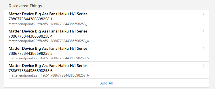

Thanks @kjknauss , thats perfect. Your BAF is advertising the FanControl, Temperature, Humidity and OccupancySensor clusters. Those should be easy to implement are are quite common, so others will benefit as well.
That’s good news. One note on fan speed, these fans have a step value of 7 (0=0, 7=100). The app, remotes, and lights on the fans mirror these steps, so it’s not a true percentage setting. The percentage ends up something divisible by 14.2857142… After much testing I have overcome this with metadata state and command descriptions to match the steps:
0=OFF
14=1
29=2
43=3
57=4
71=5
86=6
100=7
I’m guessing that doesn’t change in the matter world, but I can test when available.
Another question: Would we expect a different result if I paired the fan with Apple Home first (which BAF claims full support) and then used a pairing code from Apple to pair in OH? With most things I want OH to remain the center of my home automation and pair there first, but just wondering.
The Fan is reporting it supports FanModeSequence=2 as the control type, which means it supports setting the speed to “OFF, LOW, MED, HIGH, AUTO”, it also supports INCREASE and DECREASE commands (steps) as well as setting percentage amount, i’ll look at supporting all of those in openHAB.
Thats one of the benefits of Matter, if you commission first with Apple home, then use that to commission openHAB, the connection from openHAB to the device is direct, Apple is not involved anymore. if you were to remove it from Apple, openHAB will still be connected to the device. The device itself is the central repository for controller pairings, not Apple or openHAB .

As alway please read the README, there is new information there.
Similar results:
x out of pairing code and ip (unsure if it matters)
2024-11-09 22:51:33.237 [DEBUG] [nternal.client.MatterWebsocketClient] - sendMessage: {"id":"89b7ae61-45ad-4208-bfa9-84cbc609cc0c","namespace":"nodes","function":"pairNode","args":["XXXXXXXXXXX"]}
2024-11-09 22:51:33.240 [DEBUG] [internal.util.MatterWebsocketService] - e[0;1;90mPeerCommissioner: e[0mCommissioning device with identifier {"shortDiscriminator":12} and 1 scanners and knownAddress "undefined"e[0m
2024-11-09 22:51:33.240 [DEBUG] [internal.util.MatterWebsocketService] - e[0;1;90mControllerDiscovery: e[0mStart Discovering devices using identifier {"shortDiscriminator":12} ...e[0m
2024-11-09 22:51:33.240 [DEBUG] [internal.util.MatterWebsocketService] - e[0;1;90mControllerDiscovery: e[0mFound 5 devices using identifier {"shortDiscriminator":12}e[0m
2024-11-09 22:51:33.241 [DEBUG] [internal.util.MatterWebsocketService] - e[0;1;90mPeerCommissioner: e[0mCommissioning device e[34mSII: e[2;39mundefined e[0;34mSAI: e[2;39mundefined e[0;34mSAT: e[2;39mundefined e[0;34mT: e[2;39m0 e[0;34mDT: e[2;39mundefined e[0;34mPH: e[2;39m33 e[0;34mICD: e[2;39m0 e[0;34mVP: e[2;39m5202+3 e[0;34mDN: e[2;39mundefined e[0;34mRI: e[2;39mundefined e[0;34mPI: e[0m
2024-11-09 22:51:34.993 [DEBUG] [internal.util.MatterWebsocketService] - e[0;1;90mPaseClient: e[0mPase client: Paired successfully with udp://fe80::8e4b:14ff:fe54:cd90%enp1s0:5540.e[0m
2024-11-09 22:51:34.993 [DEBUG] [internal.util.MatterWebsocketService] - e[0;1;90mInsecureSession: e[0mEnd insecure session insecure/12267837438698760788e[0m
2024-11-09 22:51:34.994 [DEBUG] [internal.util.MatterWebsocketService] - e[0;1;90mPeerCommissioner: e[0mStart commissioning of node 2754331428455262459 into fabric 1 (index 1)e[0m
2024-11-09 22:51:34.995 [DEBUG] [internal.util.MatterWebsocketService] - e[0;1;90mController~missioner: e[0mSkipping NetworkCommissioning steps because the device is already on IP network (udp)e[0m
2024-11-09 22:51:34.995 [DEBUG] [internal.util.MatterWebsocketService] - e[0;1;90mController~missioner: e[0mExecuting commissioning step 0.1: GetInitialDatae[0m
2024-11-09 22:51:35.276 [DEBUG] [internal.util.MatterWebsocketService] - e[0;1;90mController~missioner: e[0mExecuting commissioning step 3.1: GeneralCommissioning.ArmFailsafee[0m
2024-11-09 22:51:35.313 [DEBUG] [internal.util.MatterWebsocketService] - e[0;1;90mController~missioner: e[0mExecuting commissioning step 5.1: GeneralCommissioning.ConfigureRegulatoryInformatione[0m
2024-11-09 22:51:35.382 [DEBUG] [internal.util.MatterWebsocketService] - e[0;1;90mController~missioner: e[0mExecuting commissioning step 5.2: TimeSynchronization.SynchronizeTimee[0m
2024-11-09 22:51:35.384 [DEBUG] [internal.util.MatterWebsocketService] - e[0;1;90mController~missioner: e[0mExecuting commissioning step 6.1: OperationalCredentials.DeviceAttestatione[0m
2024-11-09 22:51:35.869 [DEBUG] [internal.util.MatterWebsocketService] - e[0;1;90mController~missioner: e[0mExecuting commissioning step 7.1: OperationalCredentials.Certificatese[0m
2024-11-09 22:51:37.711 [DEBUG] [internal.util.MatterWebsocketService] - e[0;1;90mController~missioner: e[0mExecuting commissioning step 10.1: AccessControle[0m
2024-11-09 22:51:37.712 [DEBUG] [internal.util.MatterWebsocketService] - e[0;1;90mController~missioner: e[0mExecuting commissioning step 12.1: Reconnecte[0m
2024-11-09 22:51:40.565 [DEBUG] [internal.util.MatterWebsocketService] - e[0;1;90mCaseClient: e[0mCase client: Paired successfully with udp://fe80::xxxx:xxxx:xxxx:xxxx%enp1s0:5540 and parameters e[34midleIntervalMs: e[2;39m500 e[0;34mactiveIntervalMs: e[2;39m300 e[0;34mactiveThresholdMs: e[2;39m4000 e[0;34mdataModelRevision: e[2;39m17 e[0;34minteractionModelRevision: e[2;39m11 e[0;34mspecificationVersion: e[2;39m0 e[0;34mmaxPathsPerInvoke: e[2;39m1e[0m
2024-11-09 22:51:40.566 [DEBUG] [internal.util.MatterWebsocketService] - e[0;1;90mInsecureSession: e[0mEnd insecure session insecure/10709857685131737033e[0m
2024-11-09 22:51:40.568 [DEBUG] [internal.util.MatterWebsocketService] - e[0;1;90mController~missioner: e[0mExecuting commissioning step 15.1: GeneralCommissioning.Completee[0m
2024-11-09 22:51:40.782 [DEBUG] [internal.util.MatterWebsocketService] - e[0;1;90mPairedNode: e[0mNode 2754331428455262459: Created paired node with device data undefinede[0m
2024-11-09 22:51:40.782 [DEBUG] [nternal.client.MatterWebsocketClient] - onWebSocketText {"type":"event","message":{"type":"nodeStateInformation","data":{"nodeId":"2754331428455262459","state":"Reconnecting"}}}
2024-11-09 22:51:40.783 [DEBUG] [nternal.client.MatterWebsocketClient] - nodeStateInformation message {"nodeId":"2754331428455262459","state":"Reconnecting"}
2024-11-09 22:51:40.785 [DEBUG] [r.internal.handler.ControllerHandler] - Node onEvent: node 2754331428455262459 is Reconnecting
2024-11-09 22:51:40.931 [DEBUG] [internal.util.MatterWebsocketService] - e[0;1;90mInteractionClient: e[0mSubscription successfully initialized with ID 3188075149 and maxInterval 60s.e[0m
2024-11-09 22:51:40.999 [DEBUG] [nternal.client.MatterWebsocketClient] - onWebSocketText {"type":"event","message":{"type":"nodeStateInformation","data":{"nodeId":"2754331428455262459","state":"Connected"}}}
2024-11-09 22:51:41.000 [DEBUG] [nternal.client.MatterWebsocketClient] - nodeStateInformation message {"nodeId":"2754331428455262459","state":"Connected"}
2024-11-09 22:51:41.000 [DEBUG] [r.internal.handler.ControllerHandler] - Node onEvent: node 2754331428455262459 is Connected
2024-11-09 22:51:41.000 [DEBUG] [nternal.client.MatterWebsocketClient] - onWebSocketText {"type":"response","message":{"type":"resultSuccess","id":"89b7ae61-45ad-4208-bfa9-84cbc609cc0c","result":"2754331428455262459","error":"undefined"}}
2024-11-09 22:51:41.000 [DEBUG] [r.internal.handler.ControllerHandler] - updateNode BEGIN 2754331428455262459
2024-11-09 22:51:41.001 [DEBUG] [nternal.client.MatterWebsocketClient] - result type: resultSuccess
2024-11-09 22:51:41.001 [DEBUG] [nternal.client.MatterWebsocketClient] - sendMessage: {"id":"a79b491f-ec19-486e-832c-548ef0df54c9","namespace":"nodes","function":"getNode","args":["2754331428455262459"]}
2024-11-09 22:51:41.001 [DEBUG] [nal.discovery.MatterDiscoveryService] - startScan complete
2024-11-09 22:51:42.407 [DEBUG] [nternal.client.MatterWebsocketClient] - onWebSocketText {"type":"response","message":{"type":"resultSuccess","id":"a79b491f-ec19-486e-832c-548ef0df54c9","result":{"id":"2754331428455262459","endpoints":{"0":{"number":0,"clusters":{"Descriptor":{"id":29,"name":"Descriptor","deviceTypeList":[{"deviceType":22,"revision":1}],"serverList":[29,31,40,48,49,51,60,62,63],"clientList":[],"partsList":[1,4,5,6],"clusterRevision":2,"featureMap":{"tagList":false},"attributeList":[0,1,2,3,65528,65529,65531,65532,65533],"acceptedCommandList":[],"generatedCommandList":[]},"AccessControl":{"id":31,"name":"AccessControl","acl":[{"privilege":5,"authMode":2,"subjects":["14320756025586964783"],"targets":null,"fabricIndex":1}],"extension":[],"subjectsPerAccessControlEntry":4,"targetsPerAccessControlEntry":3,"accessControlEntriesPerFabric":4,"clusterRevision":1,"featureMap":{},"attributeList":[0,1,2,3,4,65528,65529,65531,65532,65533],"acceptedCommandList":[],"generatedCommandList":[]},"BasicInformation":{"id":40,"name":"BasicInformation","dataModelRevision":17,"vendorName":"Big Ass Fans","vendorId":5202,"productName":"Haiku H/I Series","productId":3,"nodeLabel":"Guest Fan\u0000\u0000\u0000\u0000\u0000\u0000\u0000\u0000\u0000\u0000\u0000\u0000\u0000\u0000\u0000\u0000\u0000\u0000\u0000\u0000\u0000\u0000\u0000","location":"XX","hardwareVersion":1,"hardwareVersionString":"1","softwareVersion":0,"softwareVersionString":"3.3.0","partNumber":"0","productUrl":"https://bigassfans.com/support/haiku/","productLabel":"Haiku H/I Series","capabilityMinima":{"caseSessionsPerFabric":3,"subscriptionsPerFabric":3},"clusterRevision":2,"featureMap":{},"attributeList":[0,1,2,3,4,5,6,7,8,9,10,12,13,14,19,65528,65529,65531,65532,65533],"acceptedCommandList":[],"generatedCommandList":[]},"GeneralCommissioning":{"id":48,"name":"GeneralCommissioning","breadcrumb":0,"basicCommissioningInfo":{"failSafeExpiryLengthSeconds":60,"maxCumulativeFailsafeSeconds":900},"regulatoryConfig":0,"locationCapability":0,"supportsConcurrentConnection":true,"clusterRevision":1,"featureMap":{},"attributeList":[0,1,2,3,4,65528,65529,65531,65532,65533],"acceptedCommandList":[0,2,4],"generatedCommandList":[1,3,5]},"NetworkCommissioning":{"id":49,"name":"NetworkCommissioning","maxNetworks":1,"networks":[],"interfaceEnabled":true,"lastNetworkingStatus":0,"lastNetworkId":"313533302d494f54","lastConnectErrorValue":null,"scanMaxTimeSeconds":10,"connectMaxTimeSeconds":30,"clusterRevision":1,"featureMap":{"wiFiNetworkInterface":true,"threadNetworkInterface":false,"ethernetNetworkInterface":false},"attributeList":[0,1,2,3,4,5,6,7,65528,65529,65531,65532,65533],"acceptedCommandList":[0,2,4,6,8],"generatedCommandList":[1,5,7]},"GeneralDiagnostics":{"id":51,"name":"GeneralDiagnostics","networkInterfaces":[{"name":"WIFI_STA_DEF","isOperational":true,"offPremiseServicesReachableIPv4":null,"offPremiseServicesReachableIPv6":null,"hardwareAddress":"8c4b1454cd90","iPv4Addresses":["c0a81e76"],"iPv6Addresses":["fe800000000000008e4b14fffe54cd90"],"type":1},{"name":"WIFI_AP_DEF","isOperational":true,"offPremiseServicesReachableIPv4":null,"offPremiseServicesReachableIPv6":null,"hardwareAddress":"000000000000","iPv4Addresses":["c0a80401"],"iPv6Addresses":[],"type":1}],"rebootCount":4,"testEventTriggersEnabled":false,"clusterRevision":1,"featureMap":{"dataModelTest":false},"attributeList":[0,1,8,65528,65529,65531,65532,65533],"acceptedCommandList":[0],"generatedCommandList":[]},"AdministratorCommissioning":{"id":60,"name":"AdministratorCommissioning","windowStatus":0,"adminFabricIndex":null,"adminVendorId":null,"clusterRevision":1,"featureMap":{"basic":false},"attributeList":[0,1,2,65528,65529,65531,65532,65533],"acceptedCommandList":[0,2],"generatedCommandList":[]},"OperationalCredentials":{"id":62,"name":"OperationalCredentials","nocs":[{"noc":"153001010224020137032414001826047970e12c2605f9a68e4137062415012711fb28c552d759392618240701240801300941043f56755d57215d25be342bcb1c6c844476b44e3b9a401c08f7108e0bb0c5d87186818af8c0fc9b4c1391998f993694b62825404a3adbb46e0549798849dea5a1370a3501280118240201360304020401183004143adebca333131bbe8afc84a49c2d456896a2ba863005149c72e76d888ccb57e9856e39da63f28e35593b9618300b4070f7f67b20fe97579bbcce0962521b942f9feadec114797e5b7db79cd182df350b29b30858462055a68bcd17334d7e3d85163580722079372da9ee40f6bab0b618","icac":null,"fabricIndex":1}],"fabrics":[{"rootPublicKey":"04828b52896c509aa109b29f97cd1a65fb05ffe4c722461b7e656c1f71bfd6c4c760ed458586b693969cb49aba1ff6f4a43af16a1c63620416b8594e7272850f9a","vendorId":65521,"fabricId":"1","nodeId":"2754331428455262459","label":"","fabricIndex":1}],"supportedFabrics":5,"commissionedFabrics":1,"trustedRootCertificates":["15300101002402013703241400182604b26be12c260532a28e4137062414001824070124080130094104828b52896c509aa109b29f97cd1a65fb05ffe4c722461b7e656c1f71bfd6c4c760ed458586b693969cb49aba1ff6f4a43af16a1c63620416b8594e7272850f9a370a35012901182402603004149c72e76d888ccb57e9856e39da63f28e35593b963005149c72e76d888ccb57e9856e39da63f28e35593b9618300b4066352f23163ae7c92c8e955576a0970d197fc6ca0d09bbd08dd765a99cb23b507641d3a7738d51dcf00c3e0e28d44aa8e002407c447390fc3ac64a143c5b15f418"],"currentFabricIndex":1,"clusterRevision":1,"featureMap":{},"attributeList":[0,1,2,3,4,5,65528,65529,65531,65532,65533],"acceptedCommandList":[0,2,4,6,7,9,10,11],"generatedCommandList":[1,3,5,8]},"GroupKeyManagement":{"id":63,"name":"GroupKeyManagement","groupKeyMap":[],"groupTable":[],"maxGroupsPerFabric":4,"maxGroupKeysPerFabric":3,"clusterRevision":2,"featureMap":{"cacheAndSync":false},"attributeList":[0,1,2,3,65528,65529,65531,65532,65533],"acceptedCommandList":[0,1,3,4],"generatedCommandList":[2,5]}}},"1":{"number":1,"clusters":{"Identify":{"id":3,"name":"Identify","identifyTime":0,"identifyType":2,"clusterRevision":4,"featureMap":{},"attributeList":[0,1,65528,65529,65531,65532,65533],"acceptedCommandList":[0,64],"generatedCommandList":[]},"Groups":{"id":4,"name":"Groups","nameSupport":{"nameSupport":true},"clusterRevision":4,"featureMap":{"groupNames":true},"attributeList":[0,65528,65529,65531,65532,65533],"acceptedCommandList":[0,1,2,3,4,5],"generatedCommandList":[0,1,2,3]},"Descriptor":{"id":29,"name":"Descriptor","deviceTypeList":[{"deviceType":43,"revision":1}],"serverList":[3,4,29,514],"clientList":[],"partsList":[],"clusterRevision":2,"featureMap":{"tagList":false},"attributeList":[0,1,2,3,65528,65529,65531,65532,65533],"acceptedCommandList":[],"generatedCommandList":[]},"FanControl":{"id":514,"name":"FanControl","fanMode":0,"fanModeSequence":2,"percentSetting":0,"percentCurrent":0,"clusterRevision":4,"featureMap":{"multiSpeed":false,"auto":true,"rocking":false,"wind":true,"step":true,"airflowDirection":true},"attributeList":[0,1,2,3,9,10,11,65528,65529,65531,65532,65533],"acceptedCommandList":[0],"generatedCommandList":[],"windSupport":{"sleepWind":false,"naturalWind":true},"windSetting":{"sleepWind":false,"naturalWind":false},"airflowDirection":0}}},"4":{"number":4,"clusters":{"Identify":{"id":3,"name":"Identify","identifyTime":0,"identifyType":2,"clusterRevision":4,"featureMap":{},"attributeList":[0,1,65528,65529,65531,65532,65533],"acceptedCommandList":[0,64],"generatedCommandList":[]},"Descriptor":{"id":29,"name":"Descriptor","deviceTypeList":[{"deviceType":770,"revision":1}],"serverList":[3,29,1026],"clientList":[],"partsList":[],"clusterRevision":2,"featureMap":{"tagList":false},"attributeList":[0,1,2,3,65528,65529,65531,65532,65533],"acceptedCommandList":[],"generatedCommandList":[]},"TemperatureMeasurement":{"id":1026,"name":"TemperatureMeasurement","measuredValue":2040,"minMeasuredValue":-2000,"maxMeasuredValue":10000,"clusterRevision":4,"featureMap":{},"attributeList":[0,1,2,65528,65529,65531,65532,65533],"acceptedCommandList":[],"generatedCommandList":[]}}},"5":{"number":5,"clusters":{"Identify":{"id":3,"name":"Identify","identifyTime":0,"identifyType":2,"clusterRevision":4,"featureMap":{},"attributeList":[0,1,65528,65529,65531,65532,65533],"acceptedCommandList":[0,64],"generatedCommandList":[]},"Descriptor":{"id":29,"name":"Descriptor","deviceTypeList":[{"deviceType":775,"revision":1}],"serverList":[3,29,1029],"clientList":[],"partsList":[],"clusterRevision":2,"featureMap":{"tagList":false},"attributeList":[0,1,2,3,65528,65529,65531,65532,65533],"acceptedCommandList":[],"generatedCommandList":[]},"RelativeHumidityMeasurement":{"id":1029,"name":"RelativeHumidityMeasurement","measuredValue":5603,"minMeasuredValue":0,"maxMeasuredValue":10000,"clusterRevision":3,"featureMap":{},"attributeList":[0,1,2,65528,65529,65531,65532,65533],"acceptedCommandList":[],"generatedCommandList":[]}}},"6":{"number":6,"clusters":{"Identify":{"id":3,"name":"Identify","identifyTime":0,"identifyType":2,"clusterRevision":4,"featureMap":{},"attributeList":[0,1,65528,65529,65531,65532,65533],"acceptedCommandList":[0,64],"generatedCommandList":[]},"Descriptor":{"id":29,"name":"Descriptor","deviceTypeList":[{"deviceType":263,"revision":1}],"serverList":[3,29,1030],"clientList":[],"partsList":[],"clusterRevision":2,"featureMap":{"tagList":false},"attributeList":[0,1,2,3,65528,65529,65531,65532,65533],"acceptedCommandList":[],"generatedCommandList":[]},"OccupancySensing":{"id":1030,"name":"OccupancySensing","occupancy":{"occupied":false},"occupancySensorType":0,"occupancySensorTypeBitmap":{"pir":true,"ultrasonic":false,"physicalContact":false},"clusterRevision":3,"featureMap":{},"attributeList":[0,1,2,65528,65529,65531,65532,65533],"acceptedCommandList":[],"generatedCommandList":[]}}}}},"error":"undefined"}}
2024-11-09 22:51:42.415 [DEBUG] [nternal.client.MatterWebsocketClient] - result type: resultSuccess
2024-11-09 22:51:42.440 [DEBUG] [r.internal.handler.ControllerHandler] - discoverChildEndpoint 2754331428455262459
2024-11-09 22:51:42.441 [DEBUG] [r.internal.handler.ControllerHandler] - discoverChildEndpoint 2754331428455262459
2024-11-09 22:51:42.441 [DEBUG] [nal.discovery.MatterDiscoveryService] - discoverChildEndpointThing: matter:endpoint:8862d8bbf0:2754331428455262459_1 matter:controller:8862d8bbf0 1
2024-11-09 22:51:42.448 [INFO ] [g.discovery.internal.PersistentInbox] - Added new thing 'matter:endpoint:8862d8bbf0:2754331428455262459_1' to inbox.
2024-11-09 22:51:42.449 [DEBUG] [r.internal.handler.ControllerHandler] - discoverChildEndpoint 2754331428455262459
2024-11-09 22:51:42.450 [DEBUG] [nal.discovery.MatterDiscoveryService] - discoverChildEndpointThing: matter:endpoint:8862d8bbf0:2754331428455262459_4 matter:controller:8862d8bbf0 4
2024-11-09 22:51:42.451 [INFO ] [g.discovery.internal.PersistentInbox] - Added new thing 'matter:endpoint:8862d8bbf0:2754331428455262459_4' to inbox.
2024-11-09 22:51:42.451 [DEBUG] [r.internal.handler.ControllerHandler] - discoverChildEndpoint 2754331428455262459
2024-11-09 22:51:42.452 [DEBUG] [nal.discovery.MatterDiscoveryService] - discoverChildEndpointThing: matter:endpoint:8862d8bbf0:2754331428455262459_5 matter:controller:8862d8bbf0 5
2024-11-09 22:51:42.453 [INFO ] [g.discovery.internal.PersistentInbox] - Added new thing 'matter:endpoint:8862d8bbf0:2754331428455262459_5' to inbox.
2024-11-09 22:51:42.453 [DEBUG] [r.internal.handler.ControllerHandler] - discoverChildEndpoint 2754331428455262459
2024-11-09 22:51:42.454 [DEBUG] [nal.discovery.MatterDiscoveryService] - discoverChildEndpointThing: matter:endpoint:8862d8bbf0:2754331428455262459_6 matter:controller:8862d8bbf0 6
2024-11-09 22:51:42.455 [INFO ] [g.discovery.internal.PersistentInbox] - Added new thing 'matter:endpoint:8862d8bbf0:2754331428455262459_6' to inbox.
2024-11-09 22:51:42.455 [DEBUG] [r.internal.handler.ControllerHandler] - updateNode END 2754331428455262459
