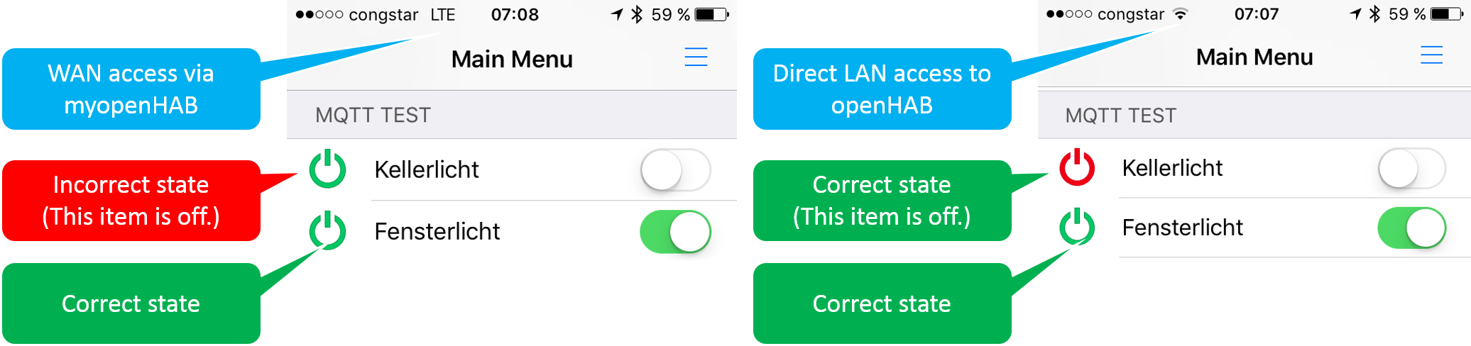

I think since the latest updates on myopenHAB I experience incorrect item states for my MQTT switches.
The item states are being shown correctly when accessed directly (local LAN) instead of going through myopenHAB.
I read back the state after each switching command from the MQTT enabled switch.
Locally all works fine. Via myopenHAB the states are always shown as active.
My reference is the openHAB iOS app.
