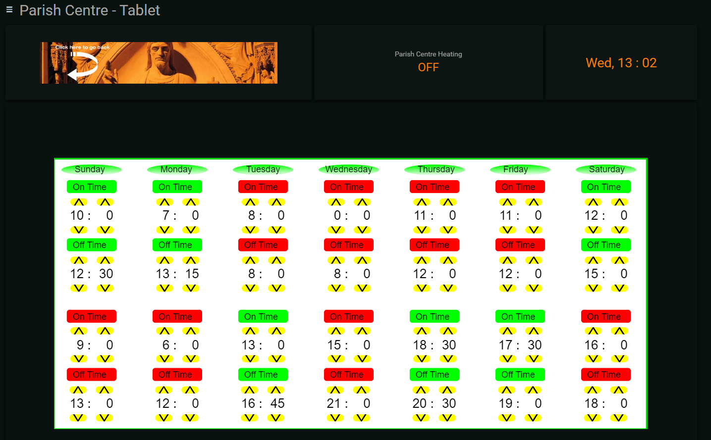

Update
I couldn’t get 14 of those widgets to fit within the Android Tablet screen in an elegant way, so I had to create a custom layout using SVG files.
Considering that I would compare my artistic skills to that of a feral infant, I’m quite happy with the result.

Thanks Rich
I’ve tried the other two timeline schedulers and using this seems to be the nearest I can get to a perfect solution for a particular use case.

I’ve managed to tweak this widget to suit the Velbus alarm times,
it can be downloaded here
http:/ /www. mdar. co. uk /dl/ forum_assets/ Velbus_Alarm.widget.zip – Removed
It requires the following naming convention, Where “AlarmName” is the only variable that has to be set in the widget.
AlarmName_Enabled
AlarmName_Wake_H
AlarmName_Wake_M
AlarmName_BedTime_H
AlarmName_BedTime_M
Update 2020 Jan
The widget has evolved quite a bit, if anyone wants to try it, the zip file is here
http://www.mdar.co.uk/dl/openhab2/Velbus_Alarm_V2.widget.zip
This uses an extra Item named
AlarmName_Type - Which in Velbus has the states “Global” and “Local”
Update
The minute and hour constraint rule has been updated, thanks to Rossko
I was having a problem where the Widgets didn’t size nicely, so I’ve spent the morning adding two size options.
One for the Font & Glyphs, another for the IconSets
I’ve added the new widget to the Zip file
