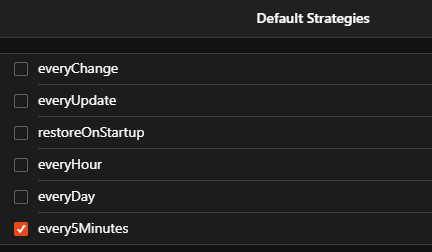

If you want anything different, you must define a persistence strategy. Note that in OH 4 you can set that through the UI now by navigating to Settings → Other add-ons → InfluxDB → Gear icon.
As soon as I add a group with a strategy, will it exclude all other items? Or will this just override the default strategy? If so, I don’t see any option to disable the default strategy.
In my OH3 setup, I have the line * : strategy = everyChange in comment and only added some items/groups to a strategy. I think nobody wants to have all his 1000 items in influx…?
I haven’t experimented with the UI configuration of persistence yet. Experiment and report back.
