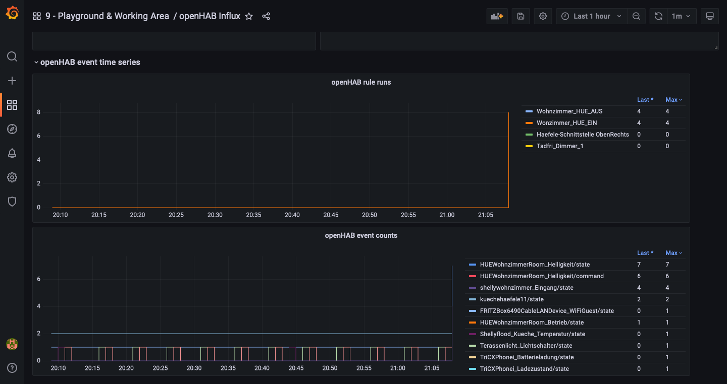

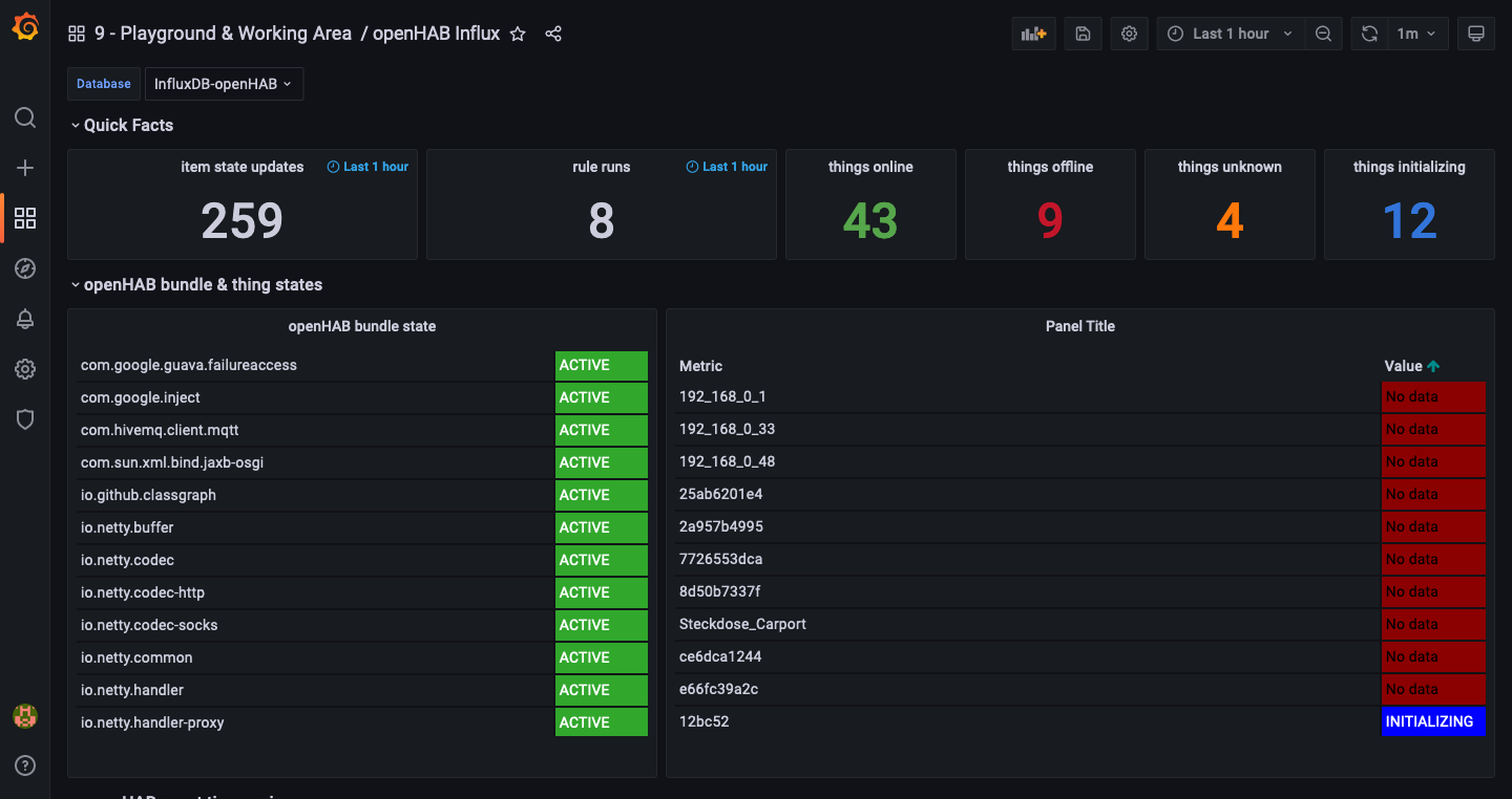

Screenshot 2022-02-19 at 21-08-22 openHAB Influx - Grafana
Screenshot 2022-02-19 at 21-08-06 openHAB Influx - Grafana

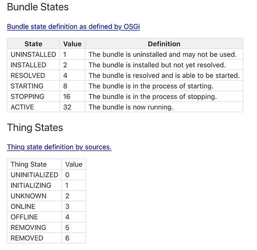

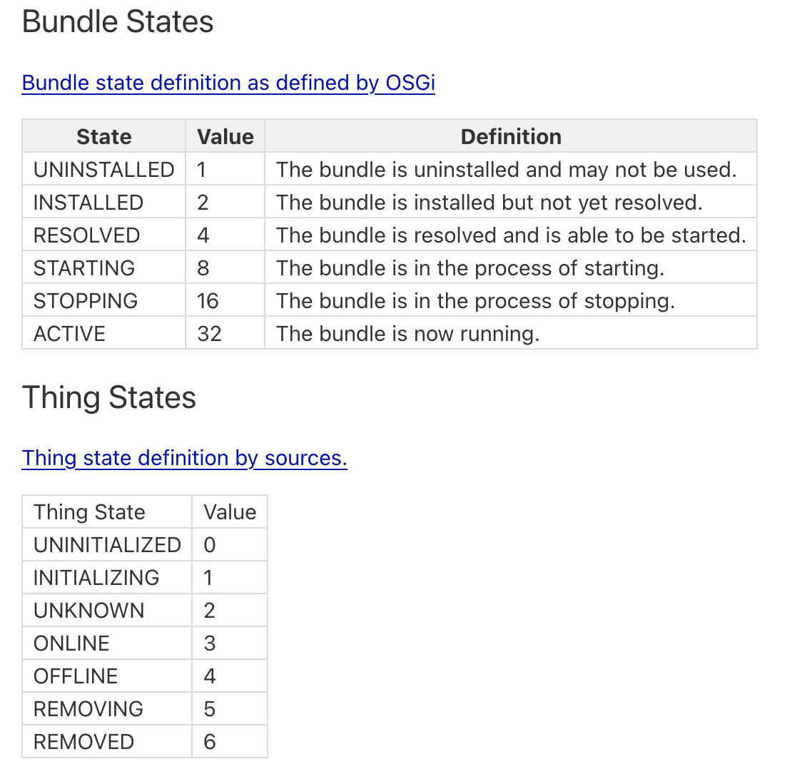

Bildschirmfoto 2022-02-19 um 21.09.53
