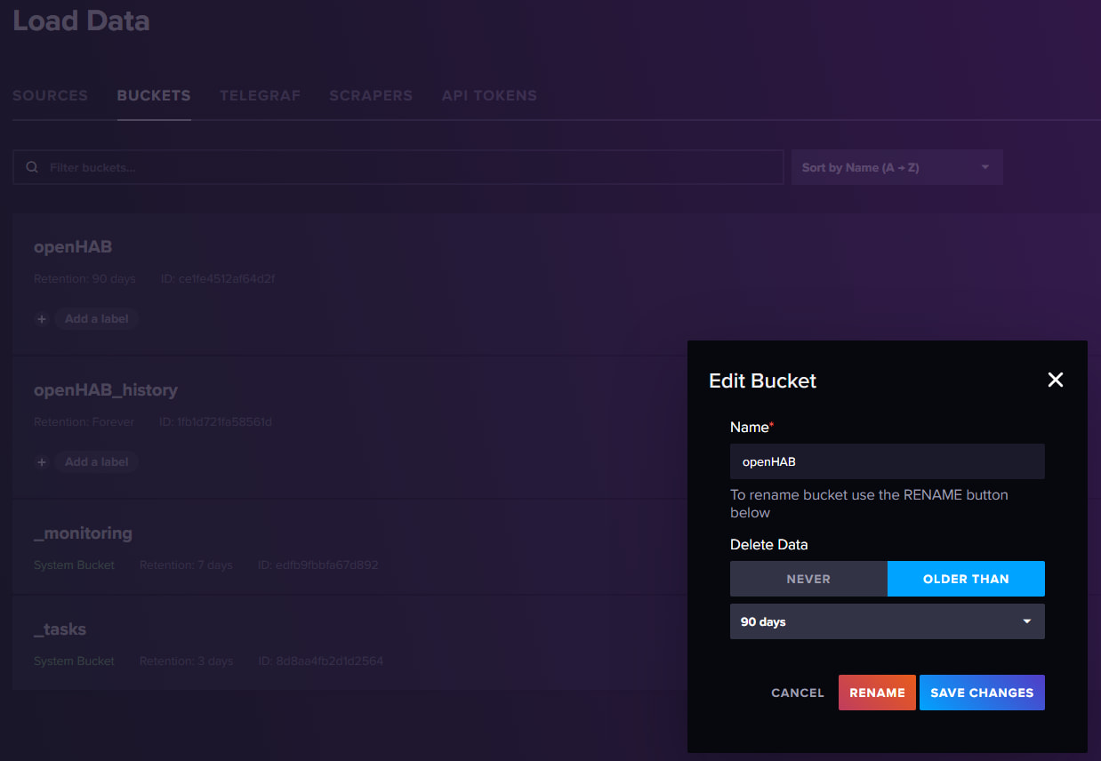

Maybe Influx V2 is something for you then. There, you can set the retention period and create downsampling rules.
import "timezone"
import "date"
option task = {name: "Einspeisung", every: 1d}
option location = timezone.location(name: "Europe/Berlin")
from(bucket: "openHAB")
    |> range(start: date.add(d: -1d, to: today()), stop: date.truncate(t: today(), unit: 1d))
    |> filter(fn: (r) => r["_measurement"] == "Einspeisung_kWh")
    |> filter(fn: (r) => r._field == "value")
    |> aggregateWindow(every: 1d, fn: last, createEmpty: false)
    |> to(bucket: "openHAB_history")
In this case, the downsampled data in the second bucket cannot be accessed directly from openHAB. But with a scipt:
