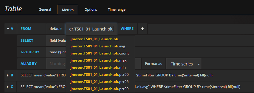

Hi There,
I have been working on influx DB & Grafana integration in order to create dashboard for jmeter performance tests in real time.
Both Influx Db & Grafana had been installed on the local machine. Samples of jmeter tests can be seen in the Grafana dashboard Table & graphs options.
Requirement is to create a table having multiple columns
First column would be txn name like TS01_01_Launch
Second column should have value of ok.avg sample
Third column should have value of ok.max sample and so on.
Can you assist me in order to write a query under table option to create a table having multiple columns by using different samples. please find below screenshot for the same.
As of now i am able to create table having values of only one sample like ok.avg or ok.min. Please find below screenshot for the same.
Can you assist me in order to write a query under table option to create a table having multiple columns by using different available samples. for example
please find below required table

Seems to work for me:
Is this what you are looking for?
Hi ThomDietrich,
Thanks for sharing above info.
i would require results in below table format.
similarly, second row should have data for another sample. i.e. TS01_02_Login
Ah… you are not looking for time series data but current values organized in both rows and columns? I’m not sure if Grafana offers this. You can use Grafanas build-in aggregation functions (avq, min, max, …) in combination with the right ā€œTable Transformā€ setting, which will work in the way you show in your example.
Hi ThomDietrich,
I tried using table series aggregation option and able to create table in the required format of having multiple columns.
Unfortunately, using the above approach data conflict occurs. It can not be used for my requirement.
Could you please assist me with another feasible approach.
