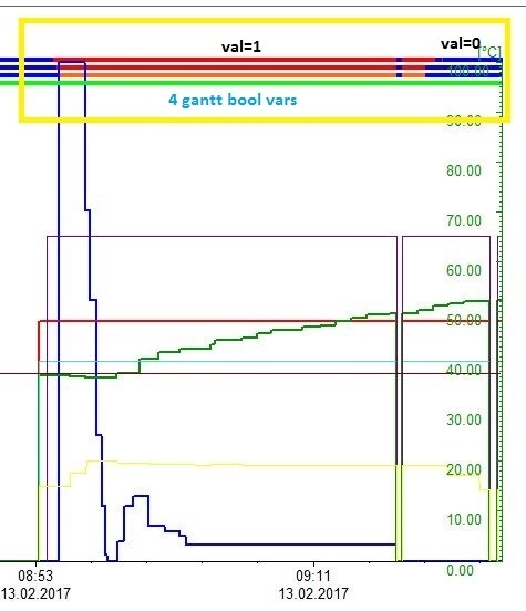

is it possible to display bool variables as gantt (one line with one color for value=0 and other for value=1) ?
Thanks.
OK, if I add mathematical shift *100 *98 *96 to basic bool variables then I can simulate gantt. Can displaying of basic value=0 be masked out ? Zero value should be not graphically displayed ?
