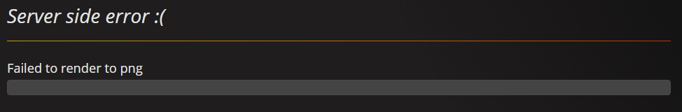

And now a new problem too
 Grafana just stopped rendering when using the direct image link. If I do it with a browser where I am logged in, it works fine, but if I change to incognito it gives me this error instead.
Logging in, makes it work again on that browser. Opening a new incognito and tries the link there, again makes it fail to render the image.
Not sure what went wrong from Grafana, I copied the JSON for the chart, deleted it, then imported it again, and now it once again works.
