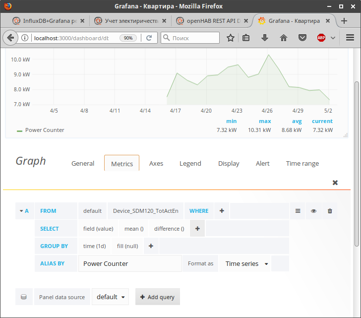

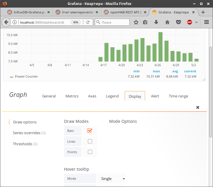

How to do Daily graphs from one power counter Item using Grafana.
  1. Here simple Power counter graph:
  2. Add Trasformation - difference field:
  3. Change GROUP BY to time(1d)
  4. Change draw mode to Bars:
