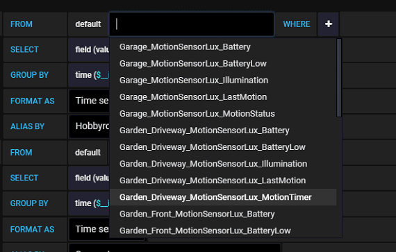

So as we can see, it stopped after I updated my Groups, but the “item” is still present.
What will I have to write then to: DELETE Garden_Driveway_MotionSensorLux_MotionStatus ish?
That sould do the trick
See:
DROP MEASUREMENT Garden_Driveway_MotionSensorLux_MotionStatus
Yes exactly…
That clears up the measurements, but the ITEM is still present:
Isn’t it possible to remove it from the item drop down list somehow?
Try
DROP SERIES Garden_Driveway_MotionSensorLux_MotionStatus
Then it ends up with this error:
ERR: error parsing query: found Garden_Driveway_MotionSensorLux_MotionStatus, expected FROM, WHERE at line 1, char 13
Maybe
DROP SERIES FROM Garden_Driveway_MotionSensorLux_MotionStatus
Have you tried to restart the graphan, the computer?
Try:
DROP SERIES FROM "Garden_Driveway_MotionSensorLux_MotionStatus"
Notice the quotes!!
Brilliant! This works!
Finally :slight_smile:
The quotes are necessary on influxdb 1.5 but not on previous versions
