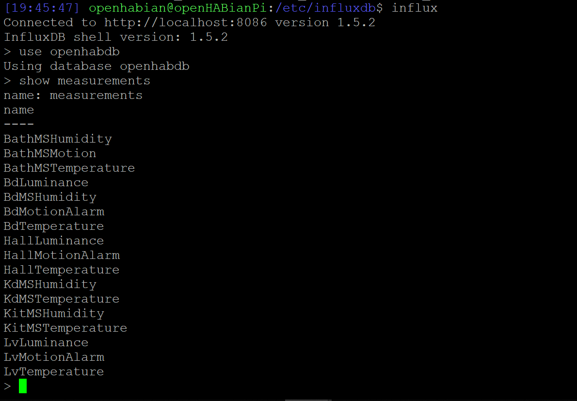

Hi! I am a litte stuck at the setup … I created db and users like described and edited the infulxdb.conf with the "sudo nano /usr/local/etc/influxdb.conf on my mac to:
  # Determines whether HTTP endpoint is enabled.
   enabled = true
  # The bind address used by the HTTP service.
   bind-address = ":8086"
  # Determines whether user authentication is enabled over HTTP/HTTPS.
   auth-enabled = true
but after a restart when i send “influx” to the terminal it does not want a pw.
when i try it with:
influx -username admin -password SuperSecretPassword123+ -host localhost
(of course with my pw)
it works as well - but again: i don’t need to enter username and pw, just influx and it connects …
installed influx with brew and the only thing i did differently is the launch at startup. i pasted what brew told me to do to launch at startup (using brew services) and not what is written on the influx-page
It connects and you can query the database? Or have you only tried connecting? At the command line you can get connected without specifying a password, but you shouldn’t be able to query the data without supplying an “auth” command. See https://docs.influxdata.com/influxdb/v1/administration/authentication_and_authorization/
What InfluxDB version are you using?
I have the same issue
Version 1.5.2
And you have an “admin” user? InfluxDB says it won’t enforce authentication unless there is an admin user.
InfluxDB was restarted? Anything interesting in the /var/log/syslog file?
thanks for pointing me to that …
i could not use the db. but admin can so everything is working properly. i feel dumb now :wink:

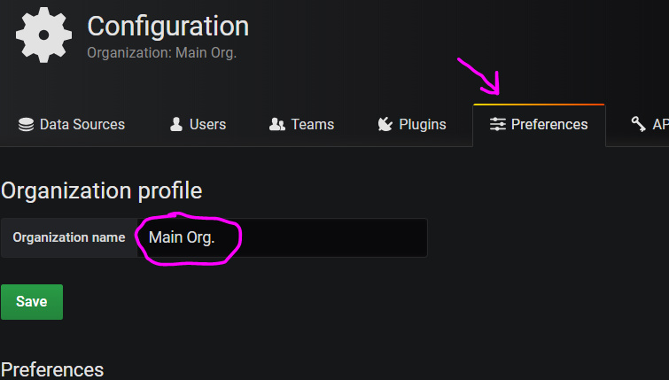

Pretty clear that the organization is a problem, but I’m not an expert on this:
eror msg="Failed to get user with id" logger=context userId=1 error="User not found"
eror msg="Anonymous access organization error: 'openhab': Organization not found"
I think you may want to make the organization name in your Configuration/Preferences to match the organization you are using in the auth.anonymous section.
Tried, and still no go. At least I get no errors in the logfile, but BasicUI wont show the dashboard.
