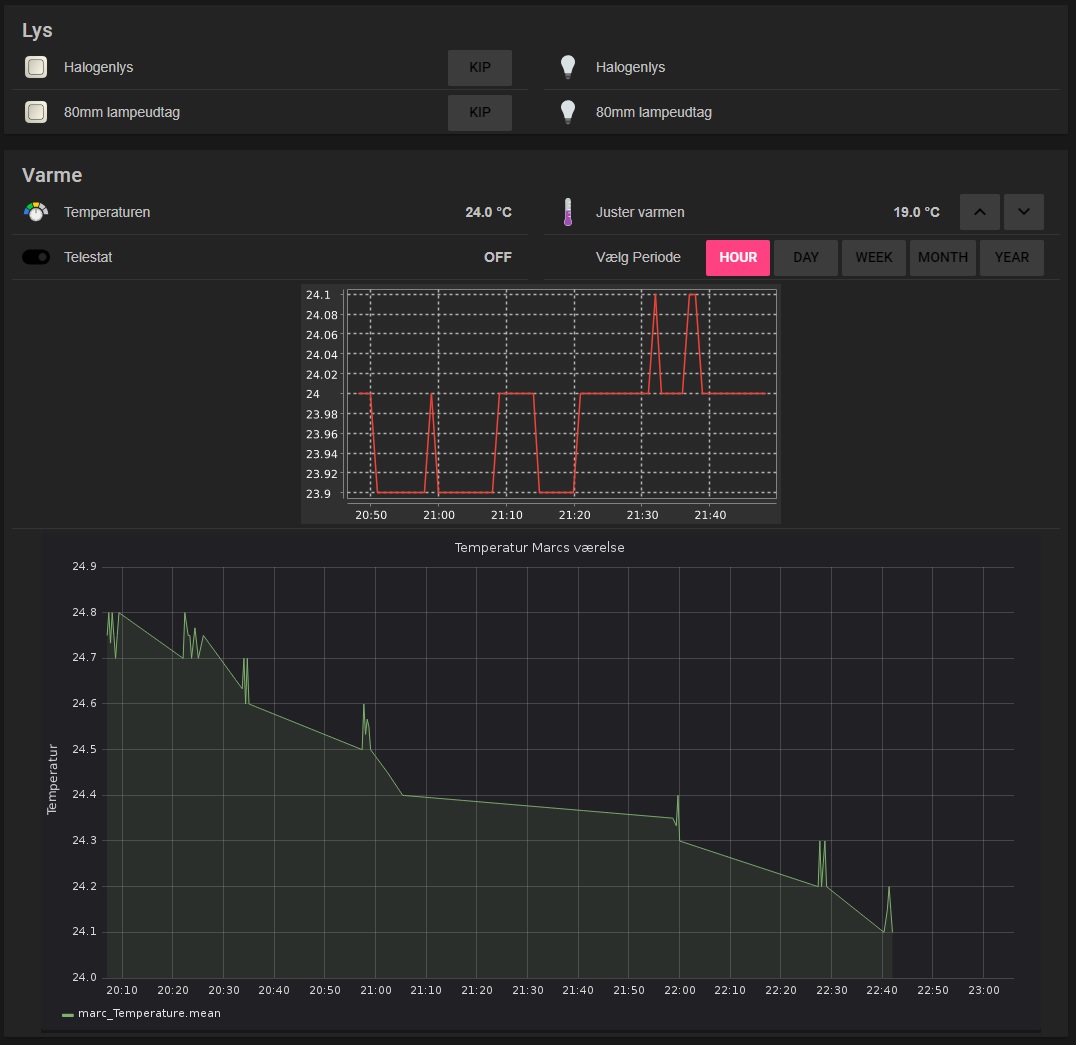

And this is how it looks. Screenshot is a few minutes old. Grafana picture hasn´t refreshed since 22.42 last night.
It’s not going to change because you’ve specified the absolute time for the time range:
You want this to me something like: “&from=now-48h&to=now”
Ahh ofcouse.. I thought the link was build from the time periode chosen like the same Grafana UI.
Now the image is updated and it seems to refresh allright. Thanks alot for your help, John!

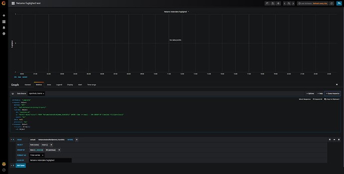

This is Grafana settings. (Screendump)
You need to find out if the data was actually written to InfluxDB (implying a write problem) or if the data is written and is therefore a Grafana read problem from InfluxDB. What is your persistence strategy? Does it cover this item? You can turn on logging in InfluxDB (I think it is on by default) and see the data being written - logs to syslog. Do you see the updates being written for this sensor? InfluxDB has a command line interface - you can try the command in green in your screenshot. If it has no data, then Grafana won’t have any data points to display.

Hmm, I think I may have found something.. But I have no idea what I´m looking at, to be honest. It seems like log is only wirtten for the specific item, when I view the Grafana dashboard. Anyway..

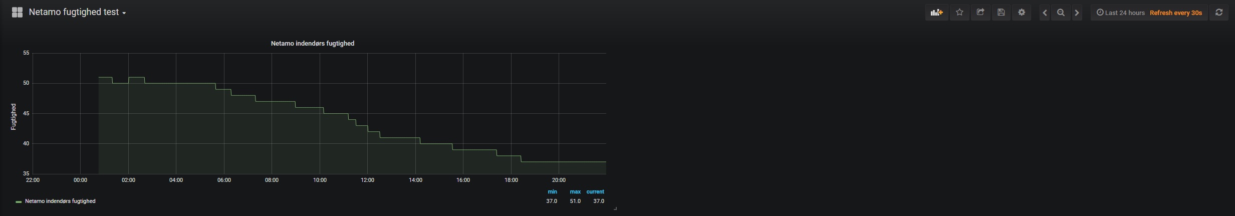

First a screendump from the dashboard with the Netamo item right now, going 24 hours back:
According to this screendump, the first data querie is 00:45.
But acording to the syslog, the first entry is 23:10:06
Jun 20 23:10:06 openHABianPi influxd[750]: ts=2018-06-20T21:10:06.559405Z lvl=info msg="Executing query" log_id=08ff~SCl000 service=query query="SELECT mean(value) FROM openhab_db.autogen.NetamoIndendRsHjemme_Humidity WHERE time >= now() - 6h GROUP BY time(15s) fill(previous)"
Jun 20 23:10:06 openHABianPi influxd[750]: [httpd] 10.4.28.30, 10.4.28.30,10.4.28.237 - grafana [20/Jun/2018:23:10:06 +0200] "GET /query?db=openhab_db&epoch=ms&q=SELECT+mean%28%22value%22%29+FROM+%22lille_bad_fugt%22+WHERE+time+%3E%3D+now%28%29+-+6h+GROUP+BY+time%2815s%29+fill%28previous%29%3BSELECT+mean%28%22value%22%29+FROM+%22stort_bad_fugt%22+WHERE+time+%3E%3D+now%28%29+-+6h+GROUP+BY+time%2815s%29+fill%28previous%29%3BSELECT+mean%28%22value%22%29+FROM+%22Nilan_Input_RH%22+WHERE+time+%3E%3D+now%28%29+-+6h+GROUP+BY+time%2815s%29+fill%28previous%29%3BSELECT+mean%28%22value%22%29+FROM+%22NetamoIndendRsHjemme_Humidity%22+WHERE+time+%3E%3D+now%28%29+-+6h+GROUP+BY+time%2815s%29+fill%28previous%29 HTTP/1.1" 200 18704 "http://10.4.28.237:3000/d/_V-4oRggk/fugtighed?refresh=30s&orgId=1" "Mozilla/5.0 (Windows NT 10.0; Win64; x64) AppleWebKit/537.36 (KHTML, like Gecko) Chrome/67.0.3396.87 Safari/537.36" 4e653a92-74ce-11e8-b7bf-000000000000 495457
23:10 is where I messed around with the item, but grafana did not show the data in the dashboard.
I removed it from one dashboard and then created a new one. And it seems like Influx as well as Grafana does indeed have the data..
Now, how come Grafana first show the data in the new dashboard at 00:45?
Strange thing though, according to the screenshot above, it has been running stable ever since. :frowning:
