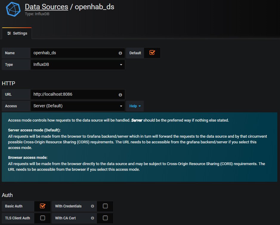

You should use the default (Server)
The screenshot on the first post is from an older Grafana version. (we should update it)
On Grafana v5.1.4 (commit: a5fe24fcc) it looks like:
Ps: Whenever we have issues configuring stuff from a tutorial, it is better to open up a new thread, describe the steps that we took, and link to the tutorial. This keeps the tutorial thread “clean” with useful info that people can grab and less troubleshooting stuff :slight_smile:
Thank you! now I can see it says Data Source is working :smiley:
