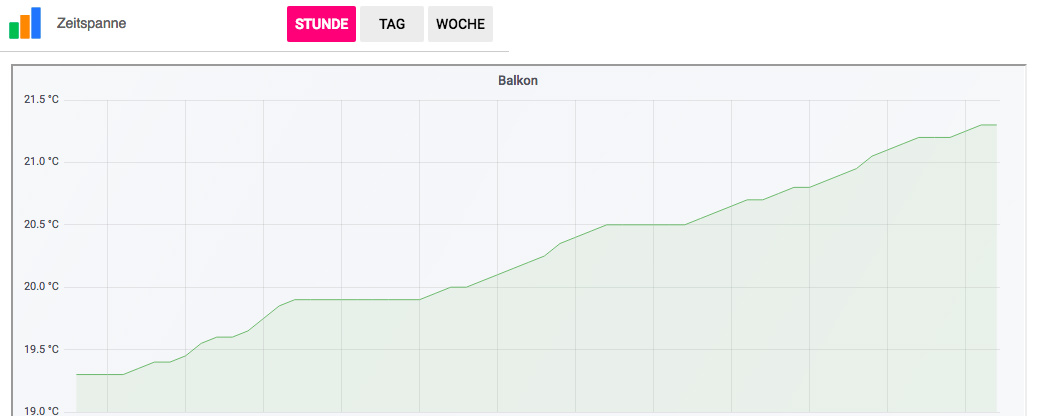

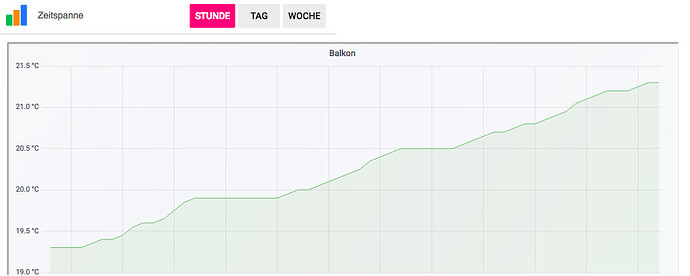

I successfully was able to show a chart with grafana, influxdb and a webview how it was described in this tutorial.
Now I want to achieve changing the duration of the chart via three buttons.

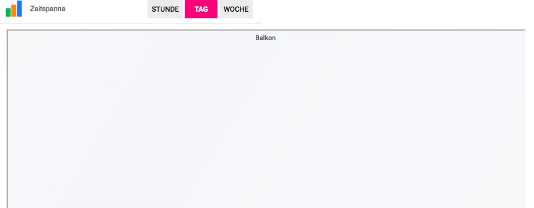

Here I have a problem when changing the visibility for web views. Only renders the title bar.
Here is the sitemap
Switch item=TemperatureSensor_ChartPeriod icon="chart" mappings=[0="Stunde", 1="Tag", 2="Woche"]
                Webview url="/static/chartHour.html" visibility=[TemperatureSensor_ChartPeriod==0, TemperatureSensor_ChartPeriod=="NULL"] height=10
                Webview url="/static/chartDay.html" visibility=[TemperatureSensor_ChartPeriod==1] height=10
                Webview url="/static/chartWeek.html" visibility=[TemperatureSensor_ChartPeriod==2] height=10
In the html file I have an iframe with the grafana url inside.
The problem is that if I switch to another view. e.g. “Day” only the header of the chart is rendered.

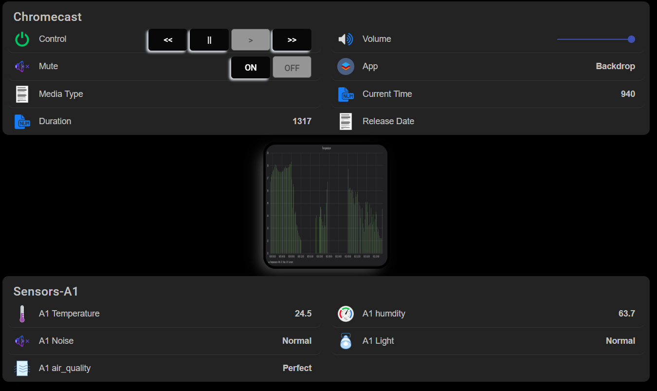

I do not know why but the image is really tiny
                Frame label="Chromecast" icon="chromecast" {
                   Default item=Chromecast_LG_ReleaseDate
           Image refresh=60000 url="http://192.168.1.110:3000/render/d-solo/WF5DmCigk/a1?panelId=2&orgId=1&&from=now-48h&to=now&width=1000&height=500&tz=UTC%2B03%3A00"
        Frame label="Sensors-A1" icon="temperature" {
            Default item=mqtttemperature icon="temperature"
