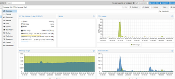

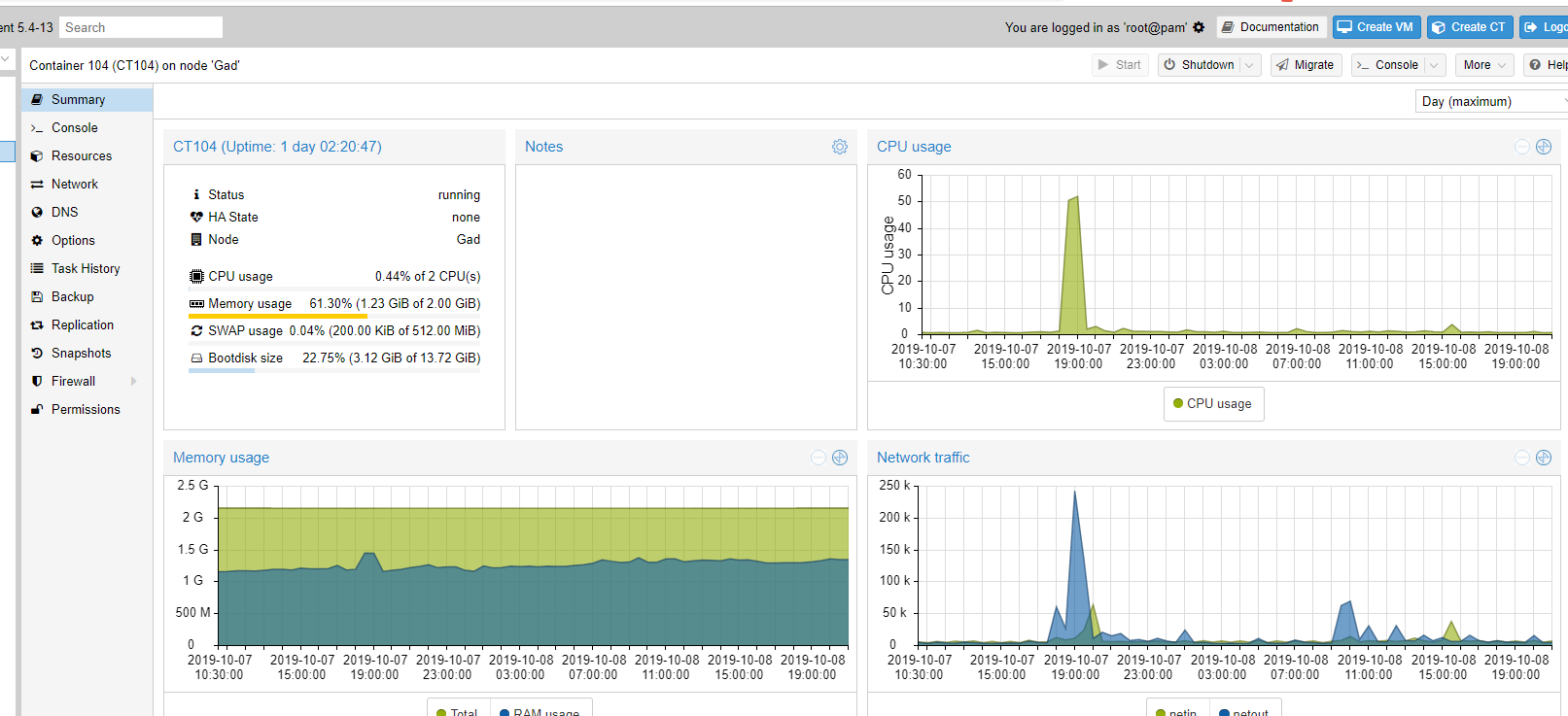

just got all up and working it was some strech but now i have Influx for all my items
what is you opinion for a home with 300+ items that is saving all to influx once an hour and on every change, can this be an issue to system preformance?
its not that i am lazy to tag my items… some of them or created with paper UI and cannot be tagged with group item …(not sure why its like this )
but if found it useful to have all items show up in Influx\Grafna
just a litle worried with preformance
but to tell the turth looking at system moniter with Proxmox tools(Web GUI)
i dont see any spikes when influx is doing the once an hour update for all items
so i think i am ok

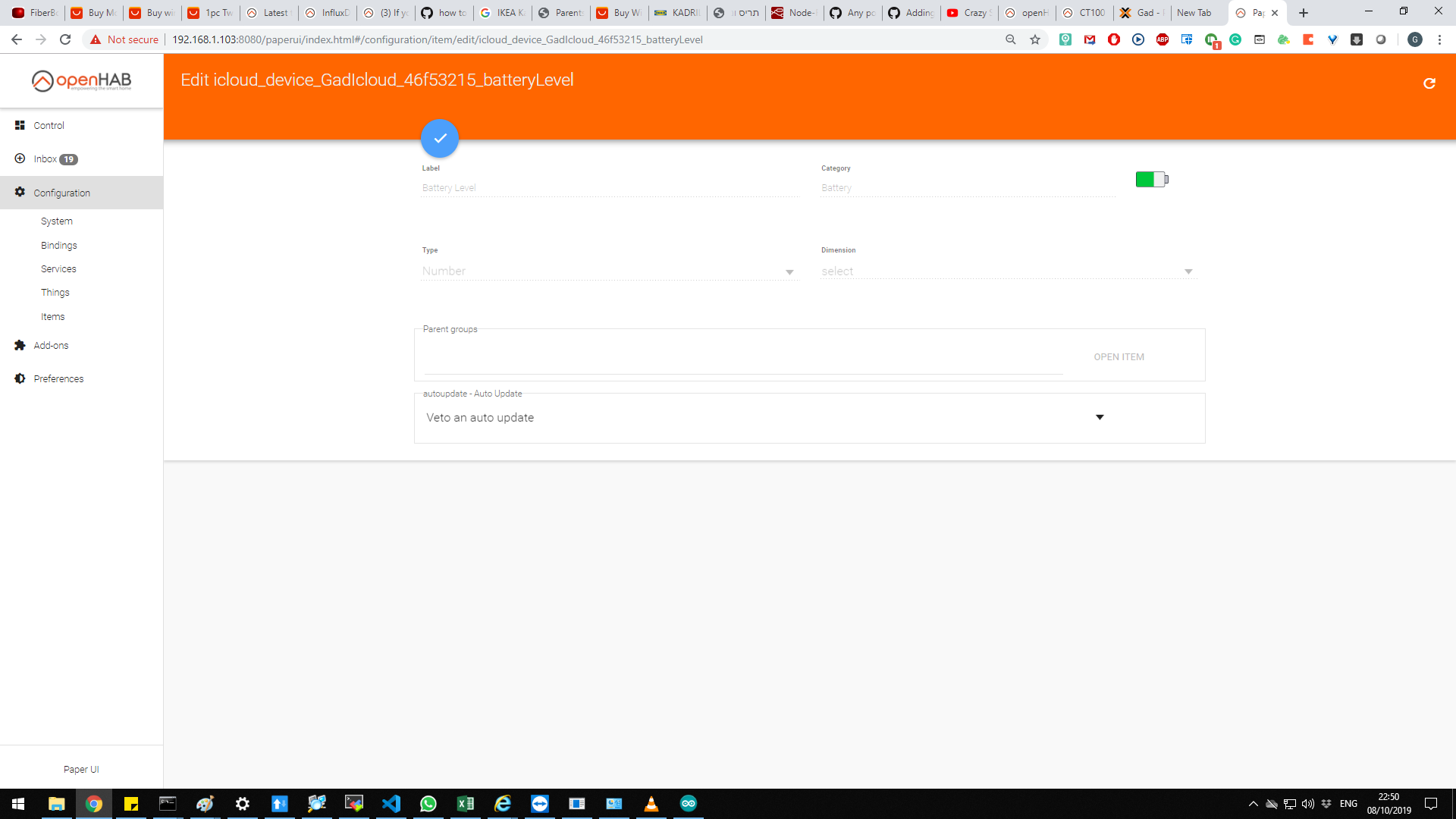

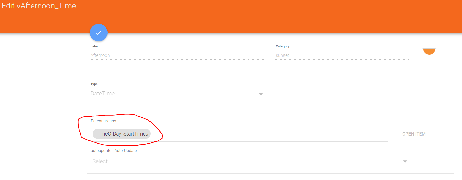

not sure if you can see but i am not able to change anythiong there
it is grayed out
maybe its the link mode…
but at this point i am not going to change it
You have Simple Mode turned on? If so that’s why. Turn off simple Mode. It’s a terrible option and should never be enabled.
i know now… but i already did my enitre setup with paper UI this way with no clue to what i was doing at that time…
and it works … so lets keep it that way :slight_smile:
