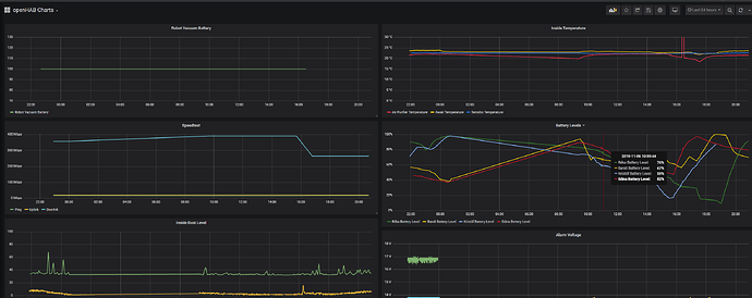

Why all my charts are rendered like this (look at the gap at the left). I had this issue previously on a different hardware and setup when testing but I thought it is just a bug, but still…
This is only a 24 hour timespan and I have data way back. The openHAB default chart shows these correctly…
This is probably a limitation with InfluxDB.
see: fill(previous) should find most recent value, even if outside query time range · Issue #6878 · influxdata/influxdb · GitHub
The values are grouped by a specific time range.
But the previous values are not being considered and therefore the first part of the graph does not have values.
I have this too and did not find a solution yet.

Grafana selects the right timespan, I can see it on the X axis that for example the previous 24h is set (until now) and it has this gap (which width varies as time goes by…). But when I select for example last 7 days, the whole is filled with the data (so the data is there…).

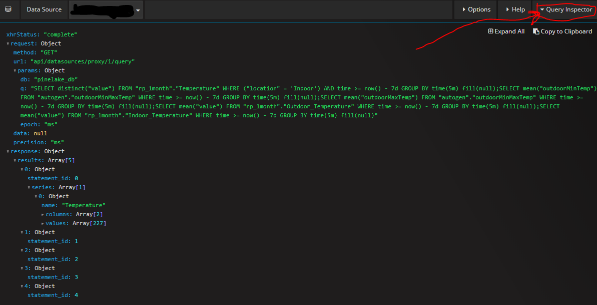

You can try to use the query inspector to see what data is being returned. Grafana displays what it gets. I’m not sure what queries MySQL allows. But you can see the query and the data it returns with the inspector. Maybe that will help? Upper right corner when editing a series.
I will try thanks!
