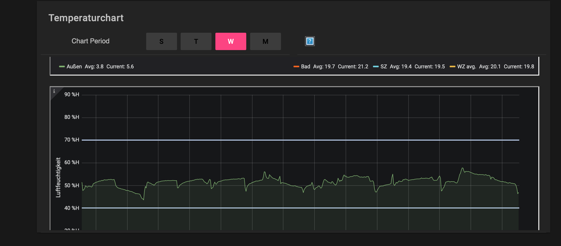

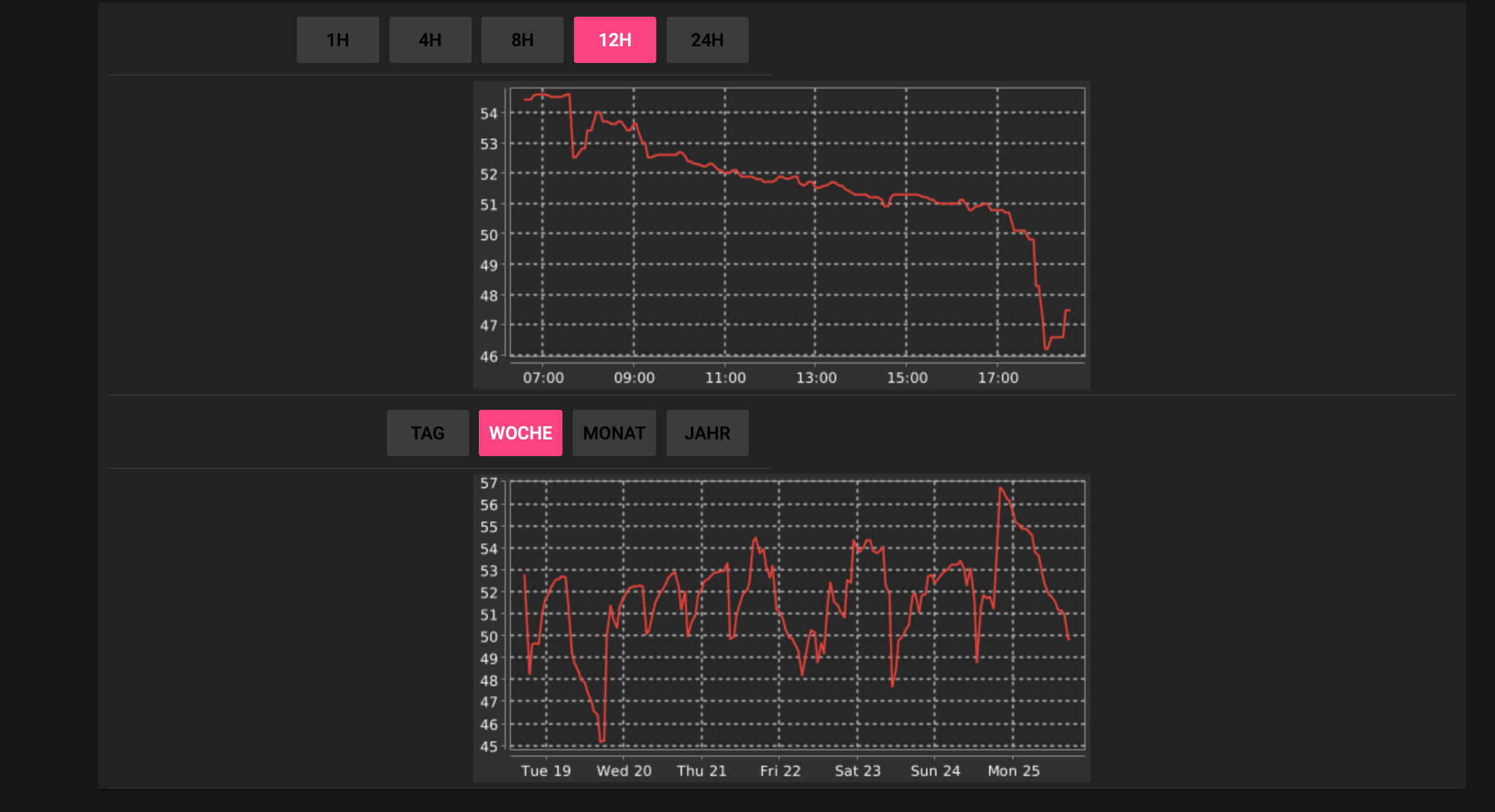

Hi everyone,
I am struggling with the webview of the charts. In my basicUI they are shown with a lot of space due to the height indicator:
Webview url="/static/Grafana-graph/chartsHour.html" height=20 visibility=[TemperaturenChart=="0"]
Now I am having different Devices. The height of 20 e.g. is fitting perfect by tablet. How can I use a “auto” sizing for different devices like mobile phone or browser without creating different sitemaps? The app is adjusting the “standard” chart item graphs without any problems (each device is putting correct chart in), but not the Webview items. Can someone tell me if this is possible to have an auto height based on the device?
Grafana with wrong fix height:
Bildschirmfoto 2019-11-25 um 18.35.24
standard example graph with correct indicator:
Would be nice if someone can help me. height=auto is not fitting. :wink:

I’d create one sitemap per device type, e.g.:
  • home-tablet.sitemap for tablets etc.
  • home-smartphone.sitemap for smartphones (smaller display)
This way you can create different visualisations depending on the device (and the available screen real estate).

@shutterfreak thank you for your quick reply. That was what I was feared of. I want to avoid creating different sitemaps. I have one wall mounted tablet I use with habPanel. The other devices I would like to feed with one sitemap using autoscale as it is for standard charts.
If there is no solution I will continue using standard charts for the App and Grafana for the wall mounted habPanel solution.
Thx.
