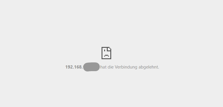

i can open the graph from a “not logged in” browser, but habpanel (frame with url = http://ip-address:3000/d-solo/3L-5BqzRk/openhab-dashboard?tab=query&orgId=1&from=now-48h&to=now&panelId=2) doesn’t show the graph:
ip-address refused the connection
as i can see the graph in another browser where i’m not logged in i think the error is with the habpanel frame, right?

apparently this i needed in grafana.ini so habpanel can embed graphs:
allow_embedding = true
