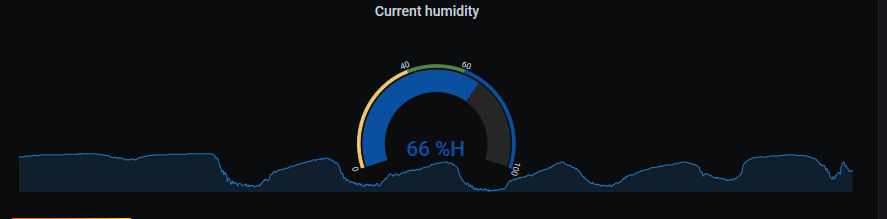

What panel did you use to have a graph behind the gauge?
I’am looking for this option, but cant find it.

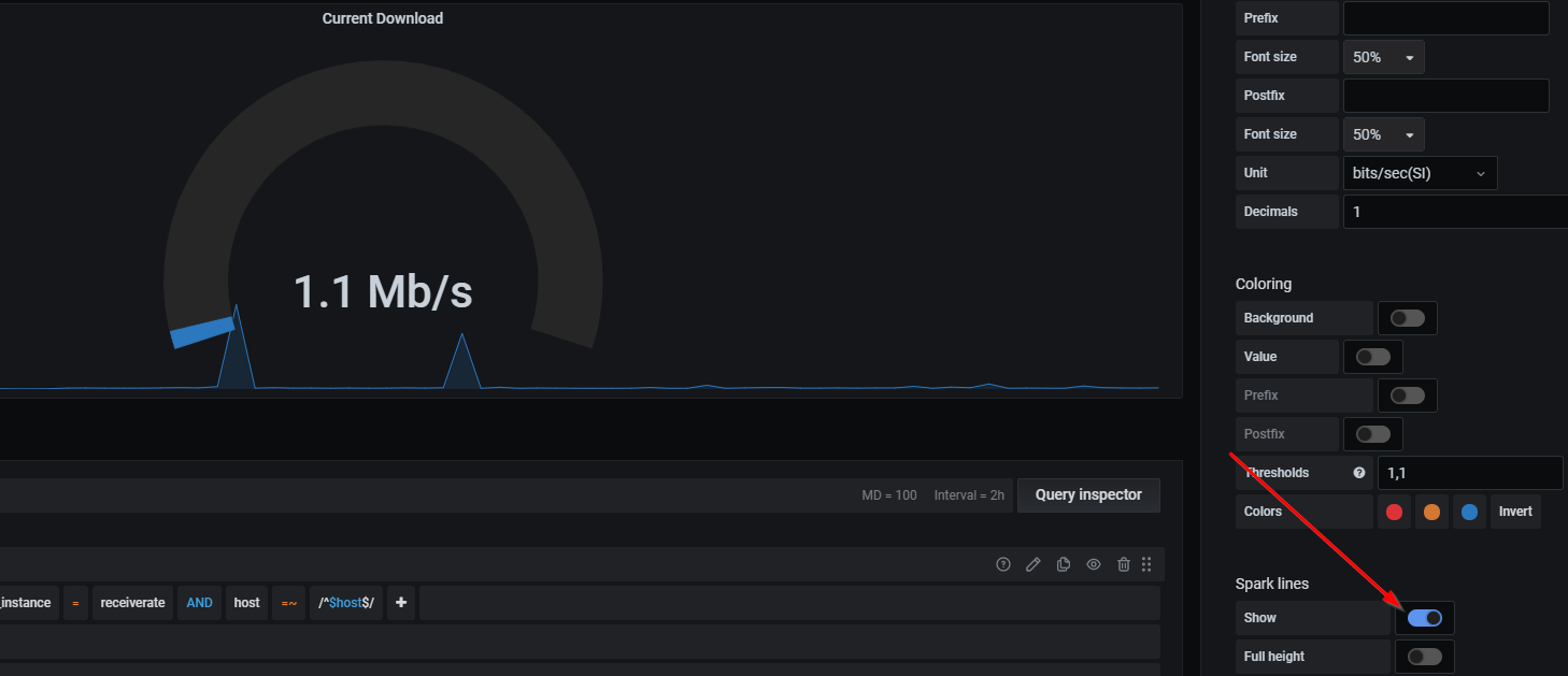

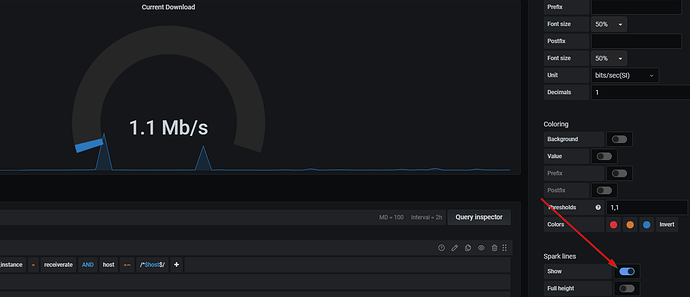

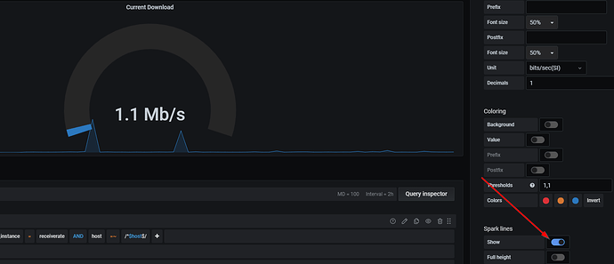

I couldn’t remember what its called but on looking at my setup I get this:
If I migrate the graph disappears. So, I kept the depreciated panel as it still works.
I think you are looking for “Show Spark Lines”.
I don’t have the option for ‘Spark lines’.
Could it be that this doesn’t work in 7.5 anymore?

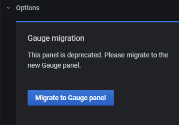

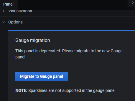

I am sorry!
I thought I already migrated to the new Gause panel. :grinning_face_with_smiling_eyes:
But it looks like I did not:
