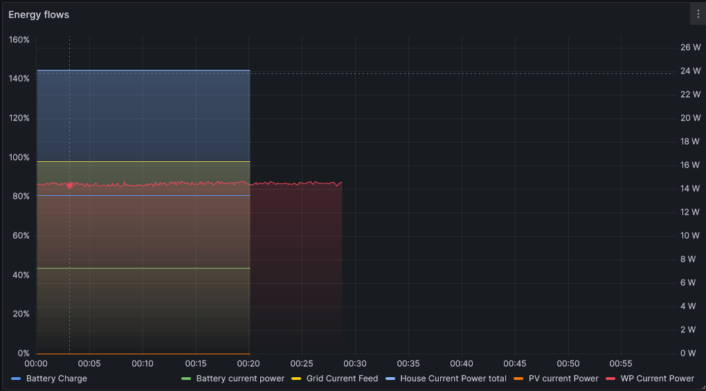

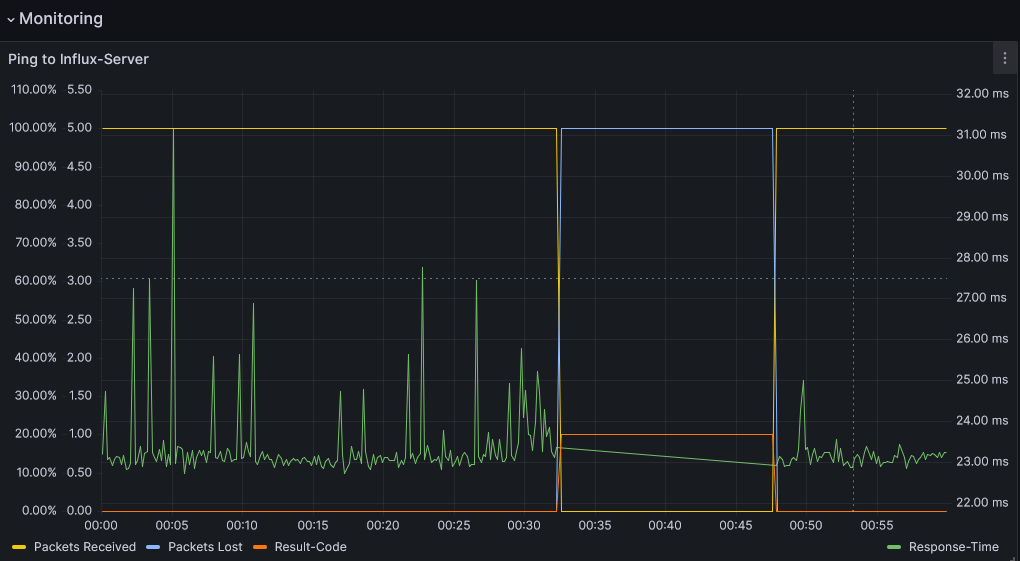

Some additional information, since the persistence stopped working tonight again:
  • The Influx-Server was down for ca. 15 Minutes.
  • once the server was back, Telegraf continued working
  • the OpenHab persistence layer did not recover from the outage
See attached screenshots.
