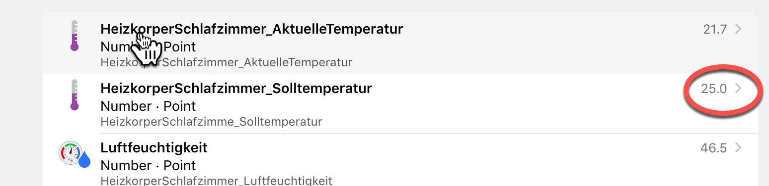

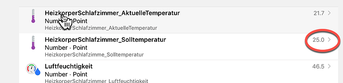

Values in OH:

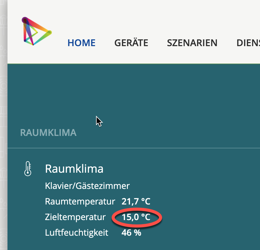

And values in innogy/livisy:
Here’s some information from the logfile. So far it seems to be ok (the bottom 3 lines, at least), but maybe it clarifies something:

2021-02-26 16:53:23.317 [INFO ] [openhab.event.ItemCommandEvent ] - Item ‘HeizkorperSchlafzimme_Solltemperatur’ received command 19
2021-02-26 16:53:23.318 [INFO ] [penhab.event.ItemStatePredictedEvent] - Item ‘HeizkorperSchlafzimme_Solltemperatur’ predicted to become 19
2021-02-26 16:53:23.321 [INFO ] [openhab.event.ItemStateChangedEvent ] - Item ‘HeizkorperSchlafzimme_Solltemperatur’ changed from 16 to 19

But that doesn’t seem to be my problem: OH receives values from innogy; e.g. in OH I see the current temperature and the target temperature too. It’s just that I can’t change the target temperature in OH (more precisely: I can change it in OH and but that doesn’t change the values in innogy/livisy and thus not on the thermostat)
