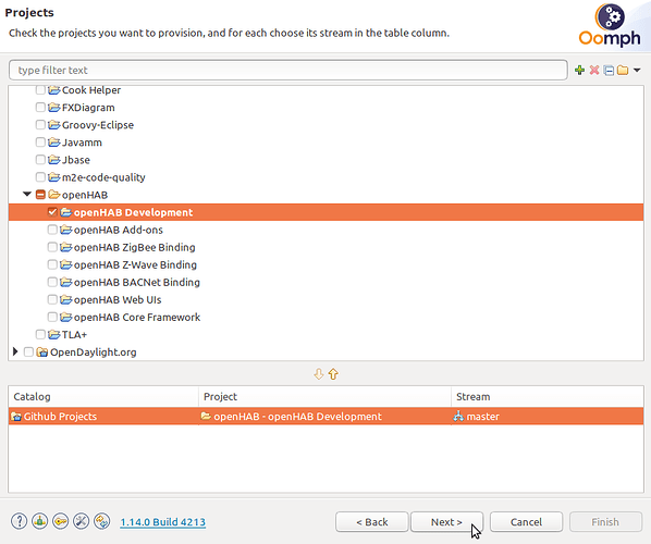

Did you read my post or read the documentation carefully and installed openHAB with Eclipse with the following option only (Or with the second option enabled: openHAB Add-ons, but followed the instructions in the documentation to close ALL addon projects):
And please, and I can’t stress this enough. Do not spent 10 HOURS wasting your time. But simply ask for help much faster.

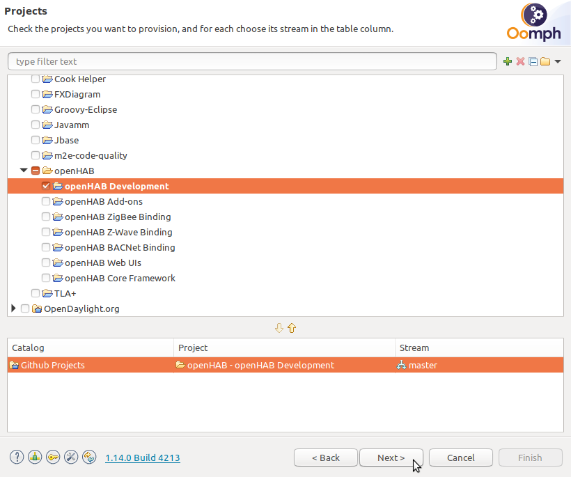

I tried it again and now i have done following steps:
  1. Git, JDK, Maven and Eclipse installed
  2. I imported only the OH-Development set
When i Run OSGi it works in Browser (paperui) without any binding.

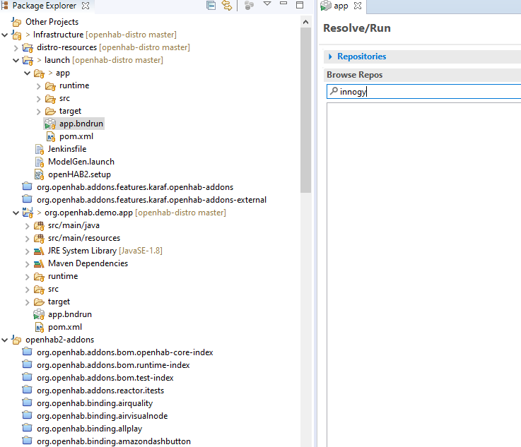

But when I want to add the innogy (or some other) binding in the app.bndrun it will not be available in the list.
See ScreenShot:
What can i do now?
It can be several things. So I would need some more information. But triggered by your experience I decided to rewrite the eclipse installation and the debug documentation. It’s currently available as pull request, but you can already see the preview here:
Edit: removed link to preview, documentation is available:
Look at the last part about starting the demo. Let me know that helps or if you still have questions.
