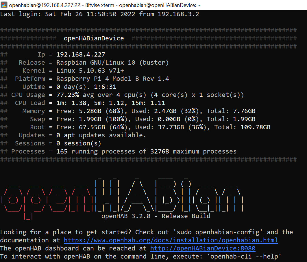

I also note the CPU load is on high side.

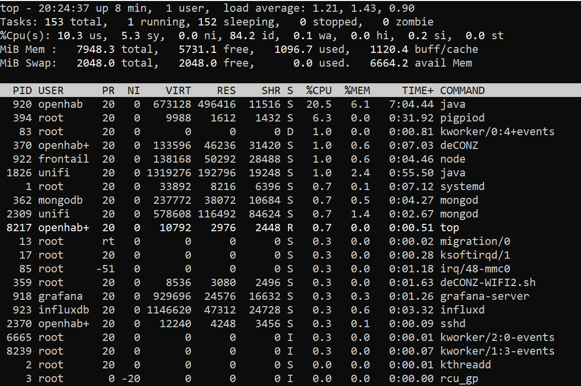

After restart I checked the running processes and the OH is taking the most resources 25-35%

I can also see OpenHAB Java process is using almost 100% cpu
