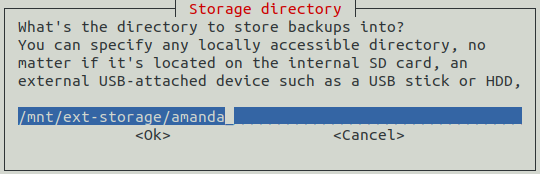

Then you are prompted if you want to setup a backup mechanism based on locally attached or NAS mounted storage. Select
Yes. -
The backup directory is requested, in my case
/mnt/ext-storage/amanda -

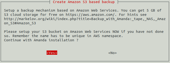

Now it gets a little confusing. The next prompt is about creating an Amazon S3 based backup. The question at the end of the prompt is
I would interpret that selectingContinue with Amanda installation?which to me is misleading.
Noquits the whole Amanda installation, when in fact it only skips the Amazon S3 configuration. SelectingNois therefore fine if you don’t need S3. -
You should then see a confirmation that installation was successful.
