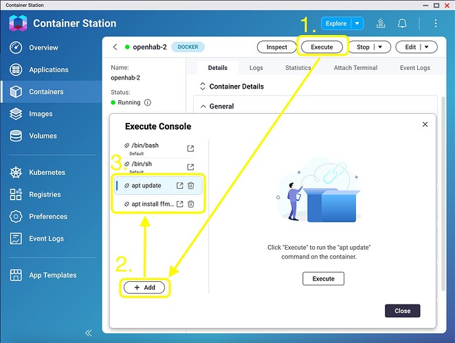

thanks for the quick responses. In the meantime i found a pretty simple solution within the qnap container station.
See pic, it is possible to execute commands within a running container. Simply execute the commands as above:
apt update
apt install ffmpeg -y
But I also like the idea to create a customized image from Dockerfile.
