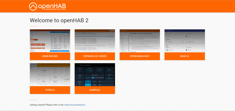

yes you are right, I confuse OpenHab2 and openHABian. Visibly openHABian included the log viewer:

I finally installed openhabian instead of openhab2, that’s what I had to do to have very easily the Log viewer.
