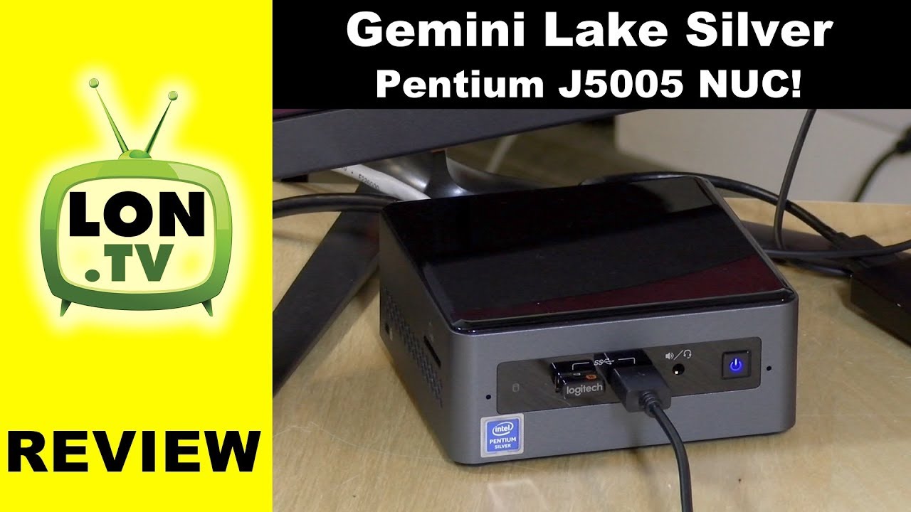

Hi Markus,
Well, I’d probably choose this one but it’s quite new, so may have to wait a little while for it to become more available.
But I have a spare NUC that used to serve as a Kodi box. Intel NUC5PPYH Next Unit of Mini PC Computing Kit (Pentium N3700 1.6 GHz Processor, HD Graphics) Intel NUC5PPYH Next Unit of Mini PC Computing Kit (Pentium N3700 1.6 GHz Processor, HD Graphics) : Amazon.co.uk: Computers & Accessories
This one isn’t as capable but would suffice for ‘tinkering’ I think.
