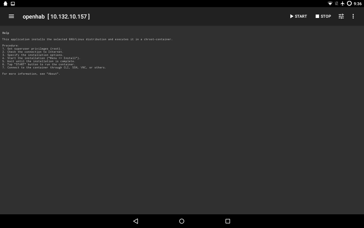

Next, we need the Linux Deploy program, with this program you can install Linux that runs in the chroot environment.
If you have an android version less than 5.0 (API 21) on your tablet, then version 2.6.0 will not work. On my 4.4, I installed 2.5.1 version.

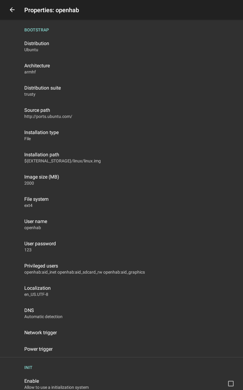

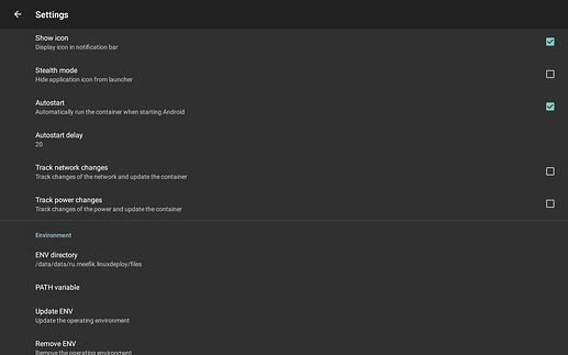

After launching the application, go to settings. Here are my settings:
You can change the “User Name”, “Password” as you wish, later Password can be changed in Linux. Selected distribution, the architecture depends on the tablet processor and the Android kernel.
Installation type = file is the most optimal.
Image size can install more.
Also install checkbox SSH.
Exit the settings, click on 3 points and select Installation, wait 15-20 minutes.
After the <<< deploy message appears, the installation is complete and you can try to start Linux and connect through the SSH client.

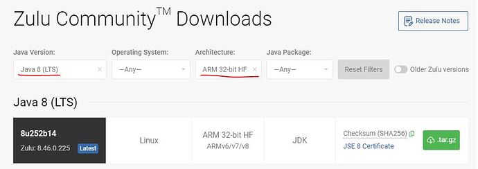

First we install Java, we will use Zulu. Since we have a 32-bit processor with hard float support, select the following distribution:
Loading …
wget -O zulu8.tar.gz https://cdn.azul.com/zulu-embedded/bin/zulu8.46.0.225-ca-jdk8.0.252-linux_aarch32hf.tar.gz

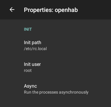

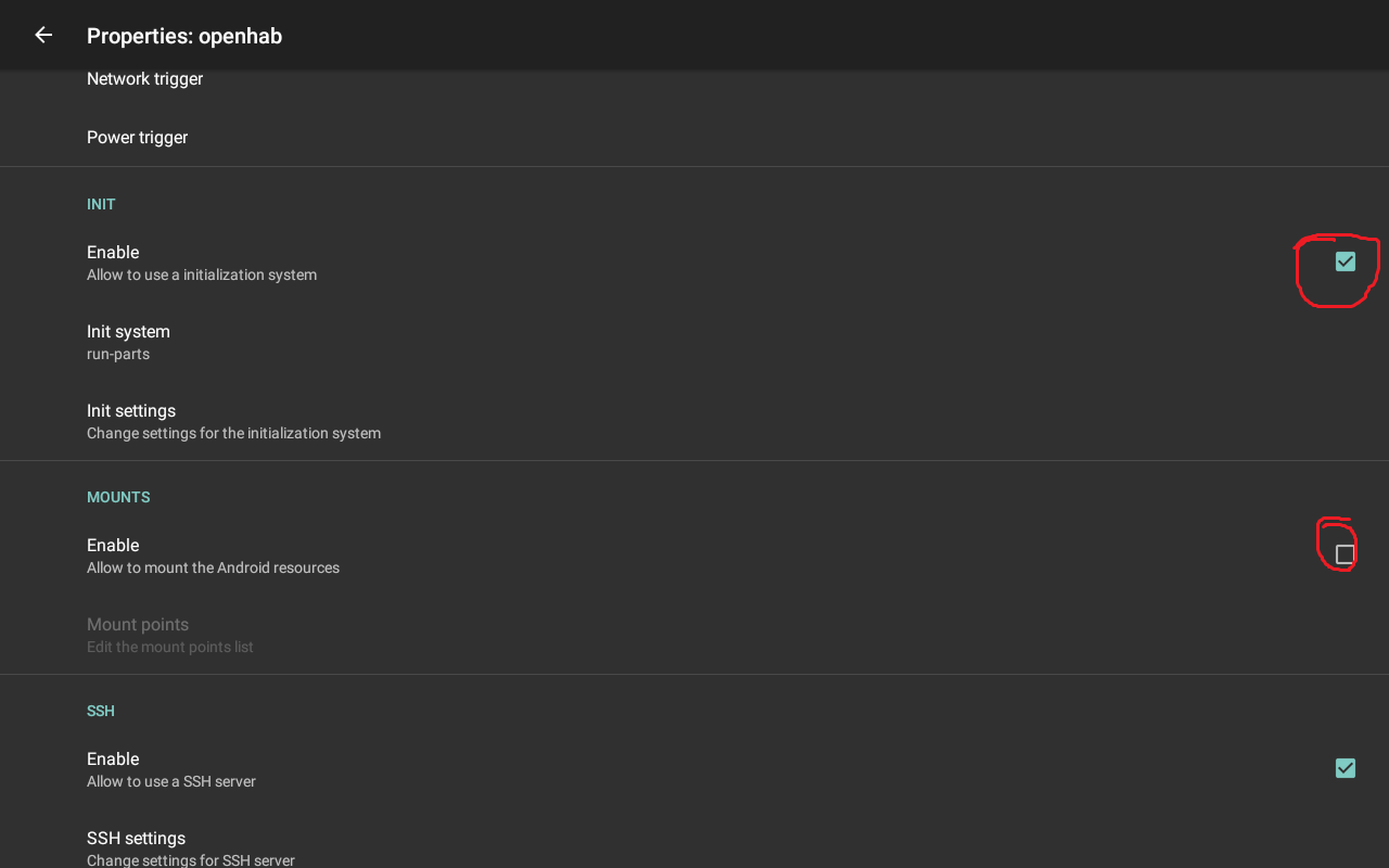

The next trick is that to save the life of flash memory, the rrd4j base will be stored in RAM. And for backup, an external microUSB card.
To do this, stop Linux with the “stop” button and go to the settings and set the checkbox “INIT” and “MOUNTS”
mount point should be /mnt/sd
Launch Linux again and edit the /etc/rc.local file:

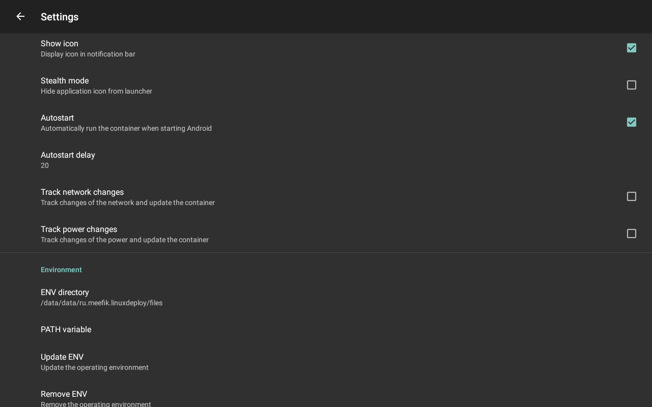

Done, the finishing touches: in the settings of the Linux Deploy program we set autoload.

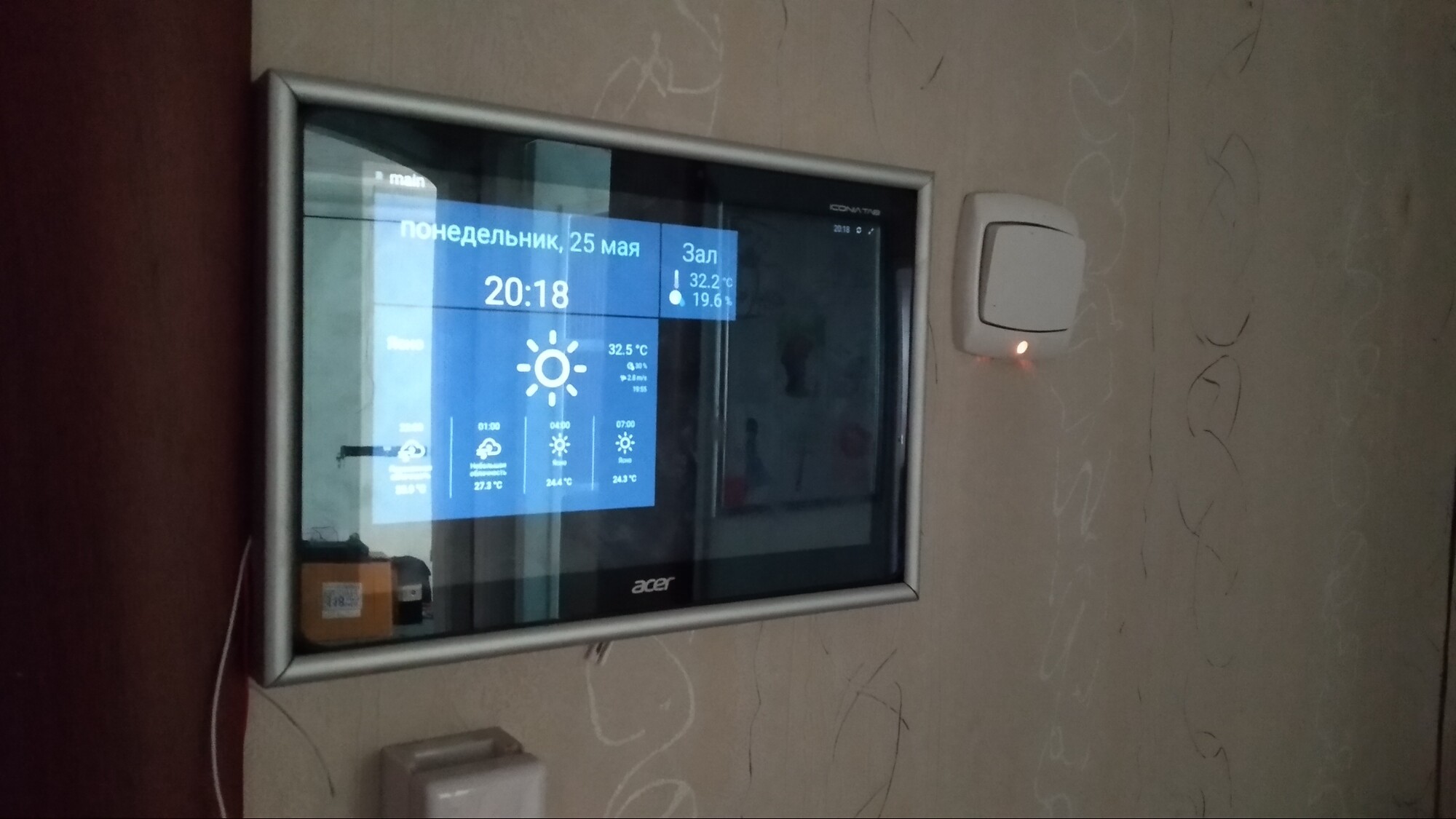

To display habpanel, a modified habpanelviewer is used, since the original version heavily loads the processor.
Wake up the tablet using Motion Detector.
You will also need Wake Lock - PowerManager for blocking falling asleep WIFI
