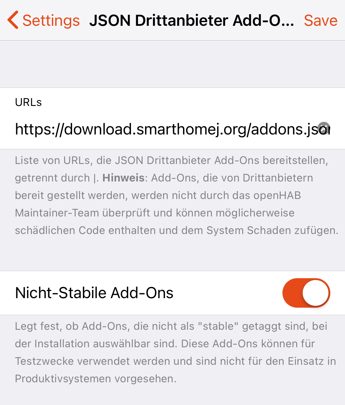

Settings-> System Services → JSON 3rd Party Add-Ons
I did that (see picture)
But the binding is not displayed, how long does it usually take?
Did you scroll down to the end on the Bindings page ?
Found it, thank you very much

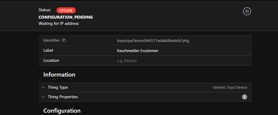

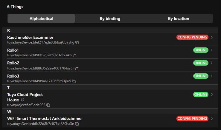

Now I have a new problem, the roller shutter switches all work but the thermostats from SALCAR (Type: TRV801W) show the following problem. See pictures
can you do something with that?
Yes and no,
this can happen, when a second application is trying to connect to the device.
Please make sure that it is only openHAB to connect directly to the device.
OK, does that mean the SmartThings app can also cause the problem?
Yes
Unfortunately that didn’t help!
Still no connection to the thermostats
Could it be that the thermostats do not go online because they are battery operated?
I have read something like this.
Yes, battery powered devices often don’t allow local connections and do not send the “I’m here” broadcasts that the binding needs. If you know the IP address, try setting it manually. You can try which protocol is correct. Either it works or not.
