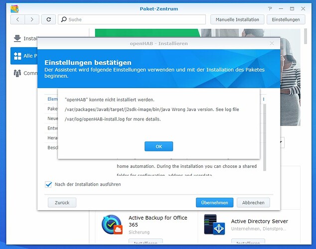

Hey everyone!
I’m trying to install openHAB on a Synology DiskStation DS218+. Unfortunately I always get an error, saying it’s the wrong java version.
I tried the two java version in the header in combination with three OH version, but always the same problem. I’m not the best in Linux things, so I don’t know how I can get to these log files :roll_eyes:
Does anyone figure out the same problem or is there anybody who can help me with that?
Thanks a lot!

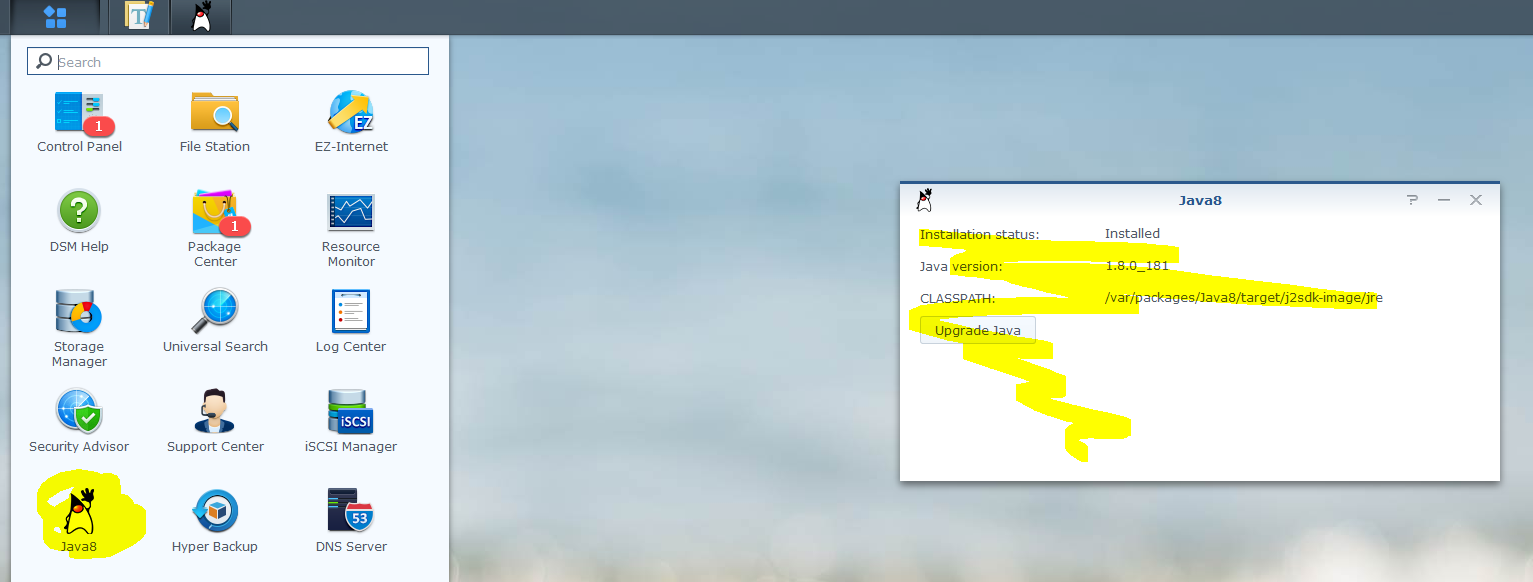

Maybe there’s an issue with that system being able to run it…not sure?
Check on this stuff in the picture. Be sure you have that java app (left) installed and that when you open it it looks like the portion on the right
