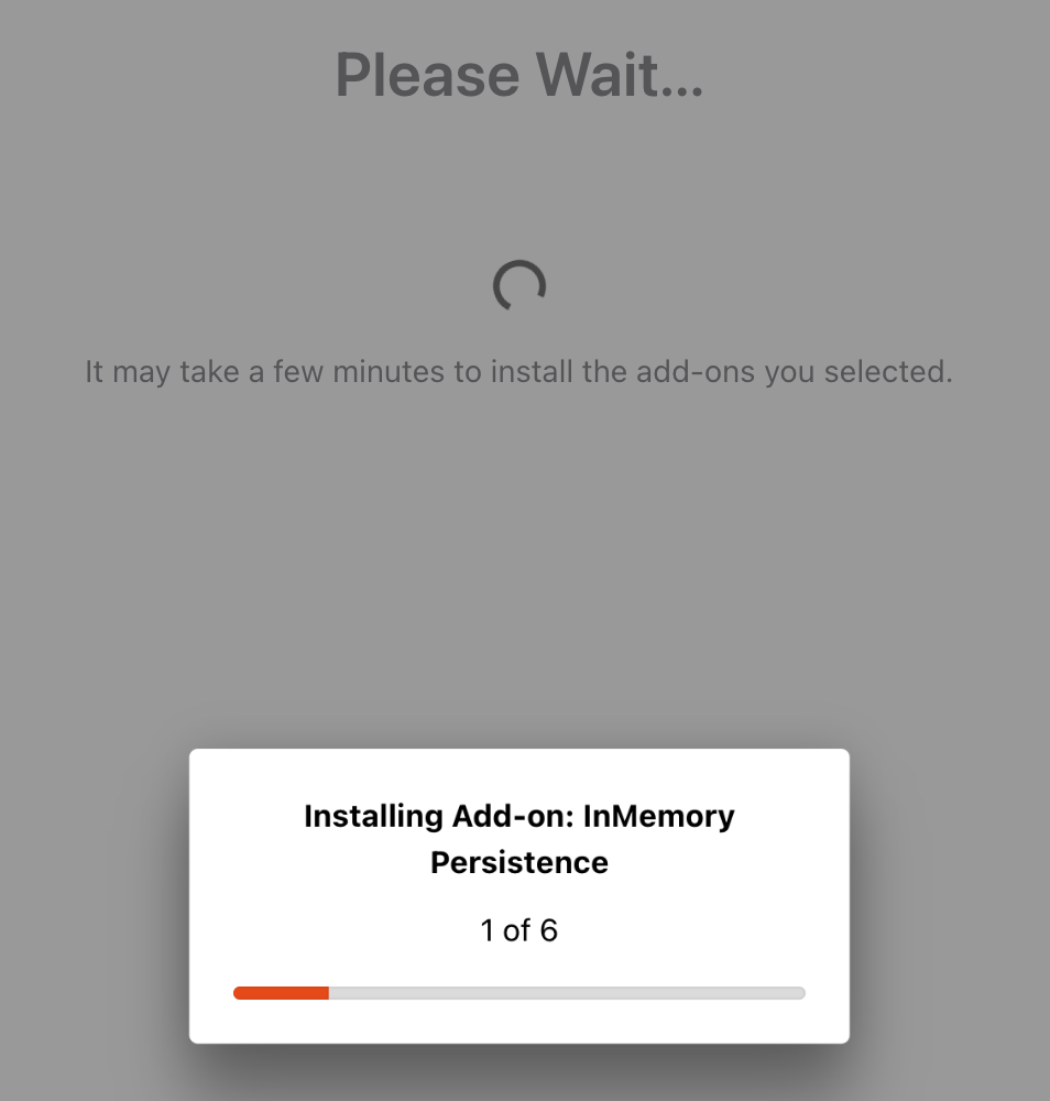

Installation of 4.3 hangs "installing add-on"
Hi All
After a long time I’ve finally got round to installing 4.3. I’ve been running 2.5.1 for ages and was absolutely satisfied with it, until I managed to delete the docker container it was running in. :joy:
I’m doing a clean install of 4.3 on a Synology Docker container and the installation hangs at the add in stage.
I select the 6 recommended add-ons and then the installing add-on window appears and then nothing. No error message and nothing is installed.
I’m running a Synology NAS DS720+ with DSM version 7.2.2, everything is up to date.
I’ve renamed the old parent folder containing the conf, addons and userdata folders so it’s effectively a clean install from new.
Any suggestions?

There isn’t any reason why it should be hanging on installing add-ons. Do you see anything relevant in the logs?

I’ve just restarted the container just in case, does this help? I’ve really no clue what I’m looking at here…
Error downloading mvn:org.openhab.addons.bundles/org.openhab.persistence.inmemory/4.3.0
2024-12-25 09:16:33.765 [ERROR] [core.karaf.internal.FeatureInstaller] - Failed installing ‘openhab-persistence-inmemory’: Error:
That points to some connectivity issue. It might also be a remote problem.
