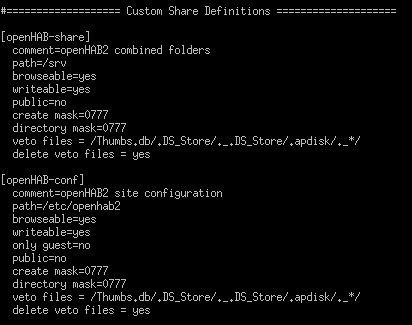

Do you have a section near the bottom of smb.conf called “Custom Share Definitions”?
Add/change the file at the bottom to this and save.
My complete smb.cfg looks like this:
[global]
  workgroup = WWG
  wins support = yes
  dns proxy = no
  log file = /var/log/samba/log.%m
  max log size = 1000
  syslog = 0
  server role = standalone server
  passdb backend = tdbsam
  obey pam restrictions = yes
  unix password sync = yes
  passwd program = /usr/bin/passwd %u
  passwd chat = *Enter\snew\s*\spassword:* %n\n *Retype\snew\s*\spassword:* %n\n *password\supdated\ssuccessfully* .
  pam password change = yes
  map to guest = bad user
[homes]
  comment = Home Directories
  browseable = no
  valid users = %S
  writeable = yes
  create mask = 0700
  directory mask = 0700
[printers]
   comment = All Printers
   browseable = no
   public = no
   path = /var/spool/samba
   printable = yes
   guest ok = no
   read only = yes
   create mask = 0700
[print$]
   comment = Printer Drivers
   path = /var/lib/samba/printers
   browseable = no
   public = no
   read only = yes
   guest ok = no
[openHAB-share]
  comment=openHAB2 combined folders
  path=/srv
  writeable=yes
  browsable=yes
  public=no
  create mask=0777
  directory mask=0777
  veto files = /Thumbs.db/.DS_Store/._.DS_Store/.apdisk/._*/
  delete veto files = yes
[openHAB-conf]
  comment=openHAB2 site configuration
  path=/etc/openhab2
  writeable=yes
  browsable=yes
  public=no
  create mask=0777
  directory mask=0777
SAMBA doesnt like me… :frowning:
