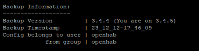

I will check if I can restore my backup from 3.4.4.
Restoring a backup from version 3.4.4 works in 3.4.5.
So the reported problem is officially solved. Thank you @mstormi.
