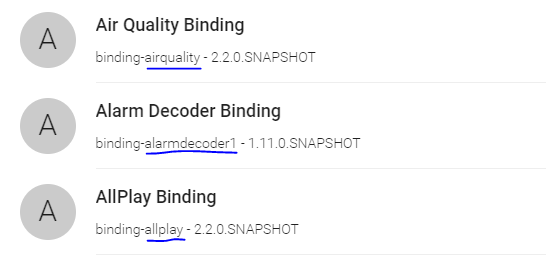

Hey guys, I think this should be possible using the openHAB REST API, e.g.:
curl -X POST --header "Content-Type: application/json" --header "Accept: application/json" "http://127.0.0.1:8080/rest/extensions/binding-airquality/install"
Edit: Tested and confirmed :tada:

I explained it in an beginner tutorial some moments ago, with the intention to refer it later. Thank you for that chance. :laughing:
I did not post all bindings information feature:list returns.
