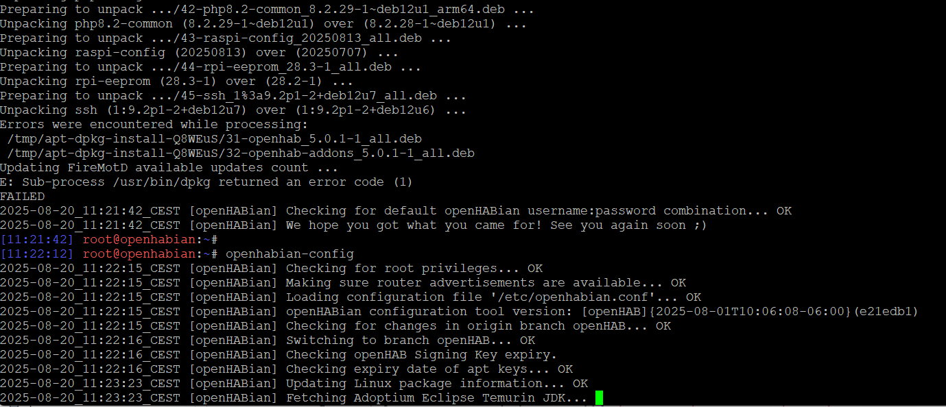

Update to OH5.01 and presupposing to Java 21. But the install script java-jre.bash get blocked and the user wait and wait ….

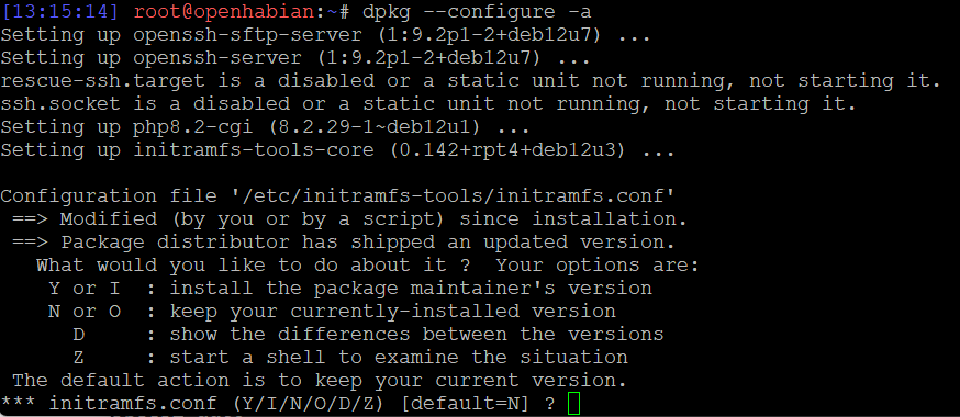

reason: dpkg --configure -a’ needed input from the user and waiting for an input in the background
workaround:
-killing the process ‘dpkg --configure -a’
-start manualy ‘dpkg --configure -a’ with a interactive input
-restarting the java install

  1. option 02 → return with error due to missing java 21
  2. option 40 → 45 → Temurin 21 → deadlock
