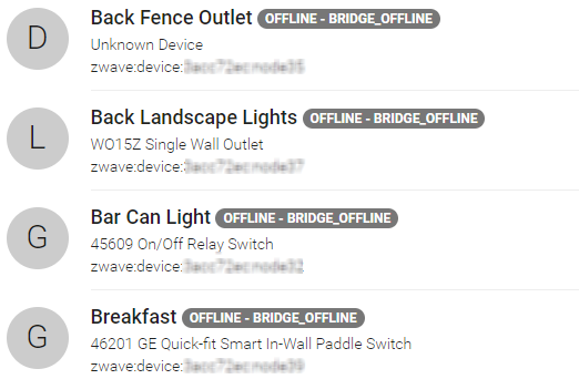

I thought I would use some of the downtime to install the Samsung TV binding. Immediately after the installation completed all of my Z-Wave devices went offline with the error message - Bridge Offline

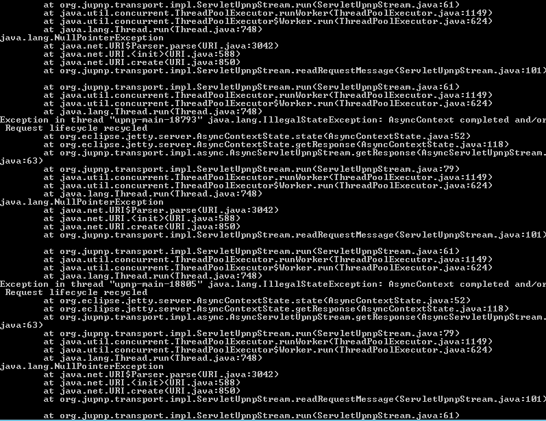

I’ve noticed a bunch of UPNP errors in the KARAF console.

This has been an issue for over a year now. The only Samsung binding that works pretty consistently is this one 2.4 RC1.
Search using this → * samsungtv-2.4.0.RC1 * ← remove the spaces before/after the *'s
I’m running jupnp 2.5.2, I’m assuming the version your running will work fine.
Keep in mind, basic functionality is with 2.4 RC1 based on the model of your SamsungTV.
