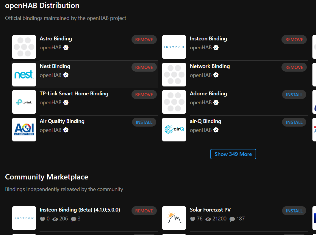

I’ve noticed running this on OH 4.1.2 that I get “Handler_Missing” errors after a reboot. Uninstalling the beta add-on and reinstalling it solves the problem until next reboot. I’m running on an rpi4 with an openhabian image. Any known issues, or ideas on what might be the cause?
I am not exactly sure but I noticed that the 3.x version is somehow showing in the add-on store causing two versions of the beta add-on to be displayed. It could be at startup the 3.x version is getting loaded instead of the 4.x one. This would prevent the addon from loading and cause the “Handler_Missing” error. Do you see any errors in your OH server logs?
In the meantime, I have opened an issue since the 3.x version should be ignored by OH 4.x servers.
https://github.com/openhab/openhab-core/issues/4180
Thanks for getting back to me. I do see three entries for Insteon when I search, but if I just scroll through the full list in the community marketplace add-on’s I only see the 4.1.0;5.0.0 Beta.
I have noticed that the regular insteon binding is showing as installed again after the uninstall/reinstall process. Is that normal? I definitely uninstalled it originally before I installed this addon.
I did some digging and I don’t see anyting in the openhab.log or events.log until I uninstalled and reinstalled. I do see something about a missing 4.2.0 Snapshot xml during boot. 4.2.0 Snapshot is the version listed for the regular insteon binding. Maybe its related?

Can you confirm that you don’t have the official and beta binding installed at the same time? The official binding needs to be uninstall prior to installing the beta version. Using the console command below, the beta version would have an extra item related to the karaf wrapper.
bundle:list | grep -i insteon
Can you please confirm that your existing setup worked without any issue when you switched to the beta binding? There shouldn’t be any changes in the way the legacy binding is interacting with your devices.

Interesting… It did not cross my mind to check on this as I did a clean container install with no carry over, and then installed the Beta from the marketplace.
This is what the command shows
openhab> bundle:list | grep -i insteon
266 │ Active │  80 │ 4.3.0.202409202335    │ openHAB Add-ons :: Bundles :: Insteon Binding
269 │ Active │  80 │ 0                     │ wrap_file__openhab_userdata_tmp_kar_org.openhab.binding.insteon-4.3.0-SNAPSHOT_org_lastnpe_eea_eea-all_2.4.0_eea-all-2.4.0.jar
And on the UI it has:
Does that look the way it is supposed to?

It does. The fact that both the official and beta versions are displayed as installed in MainUI, when only the latter is in reality, is a known issue. The only way to confirm it at this point is to run the console command.
Assuming you are running your main OH server in a container, you could copy the data volume and bind it to your test container. That way you could test the migration as well including the backward compatibility.
Also, since you are running a separate instance, is your main OH server up and the Insteon binding on that instance up as well? If so, you should disable the network bridge to disconnect it from your modem. Having multiple applications connected to the same modem produce unreliable results including the partial modem database you have experienced.
