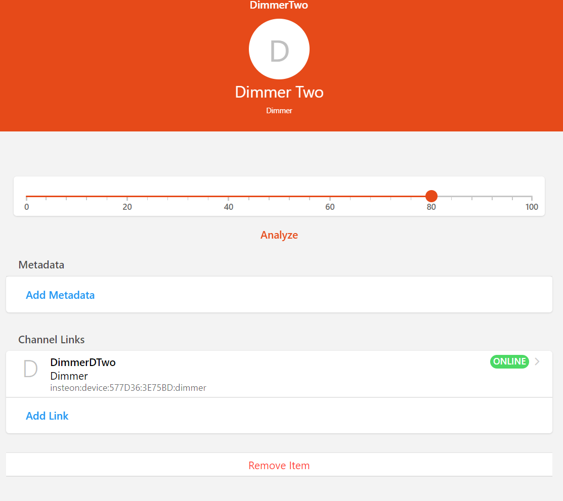

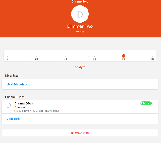

I setup Items for the 2457D2 dimmers and Linked them to the respective Things.
All the dimmers in Items show linked okay like this one:
The first and third dimmers in Items are new dimmers. The second and fourth are dimmers previously attached to the Hub when Insteon was alive. I have previously factory reset all devices. Whenever click on an Item and try to dim to a certain level on fully on (or fully off if I manually turned device on), the previously installed dimmers work beautifully. The newer ones never respond.

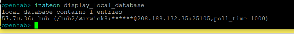

It looks like the database on your hub has been totally erased. I’m surprised anything is working. Here’s what a part of mine looks like:
openhab> insteon display_local_database
local database contains 60 entries
17.93.87: plm controls groups (254) and responds to groups (1)
17.94.B0: plm controls groups (254) and responds to groups (1)
19.8A.2B: plm controls groups (254) and responds to groups (1)
19.8B.65: plm controls groups (254) and responds to groups (1)
24.11.9D: plm (/dev/ttyUSB0)
You’ll need to reconfigure the hub as a controller to send commands to the device and as a responder if you want it to respond to commands from the device. You can do this with insteon terminal.
This shows how you have the devices and channels configured in openHAB. This looks good. The problem is with the physical configuration of the insteon devices themselves.
