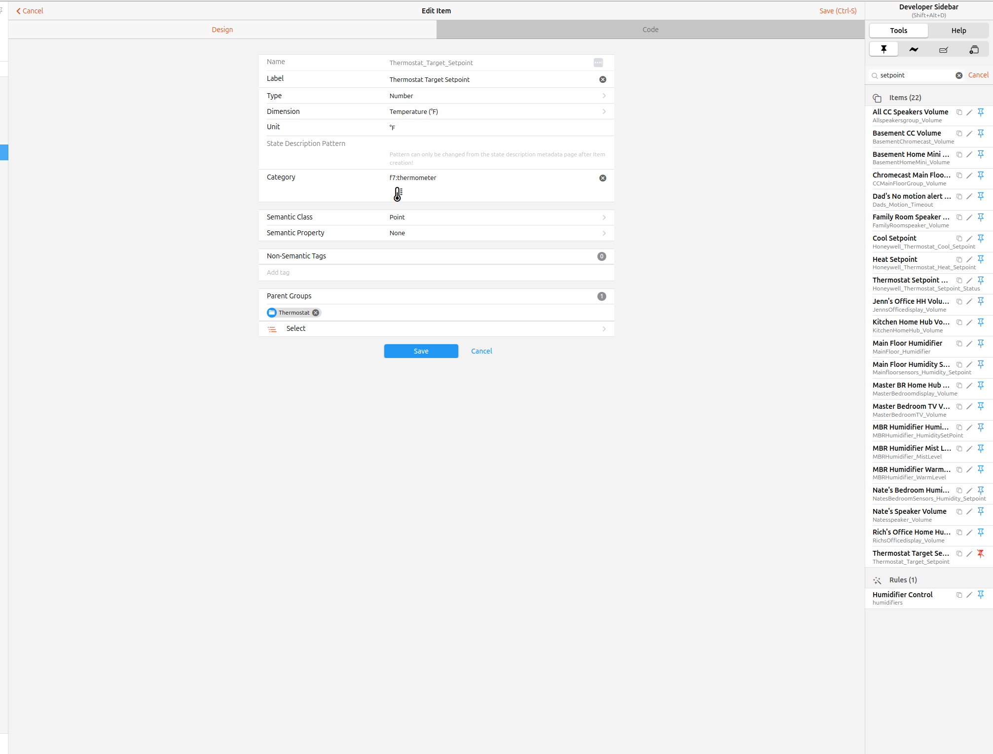

OK, in the middle of the screen there’s two fields:
Semantic Class: click on this and select “Setpoint”
Semantic Property: click on this and select “Temperature”
I can’t post a video right now so you get screen shots.
alt-shift-d to bring up the developer sidebar
Search for the Item you care about and pin it.
Click the pencil icon
Notice how this is shown as a sensor and not a control.
Click “edit” in the upper right
In the middle there’s “Semantic Class”. Click that and choose “Setpoint”.
Under that is “Semantic Property”. Click that and choose “Temperature”.
Click “save”. You should now see a setpoint widget for this Item.
